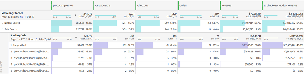

I have a specific set of Marketing Channels that depend on the tracking code to categorize traffic. I can see traffic on all of these channels. However, if I do a breakdown by Tracking Code, I get a large chunk of all metrics attributed to "Unspecified".
Below is a screenshot of this ocurring with Paid Search:
What could be causing this? I ran Omnibug and sent tagged traffic to my site. I can see that, on the first visited page, the xdm.marketing.trackingCode is filled with the correct CID, but on subsequent page views the field comes up empty. Is this the intended behaviour?

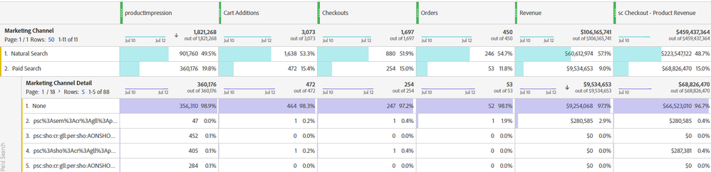

I looked into it and my Marketing Channel Detail is set to "Tracking Code" for all of the channels that would capture paid traffic. If I break down Marketing Channel by Marketing Channel detail I get the same issue.
If I understand correctly, the "detail" dimension will have the same expiration/attribution as Marketing Channel, in which case, could it still be the mismatch between expiry dates that is causing this, or could this be a deeper issue in my setup or the way my website works?
Marketing Channel Detail would be the same attribution as Marketing Channel... but if you are setting with / using Tracking Code, you are likely picking up an attributed value.
The other option is your Paid Search Detection...
In your processing rules, hypothetically you are looking for ANY rule of:
  • Paid Search
  • cid=paid
And your tracking code is the value of cid
But what if your Paid Search detection is also looking for UTM_Medium=paid or UTM_Medium=cpc?
Those are not cid, your tracking code will be empty, but your paid search rule is still triggered

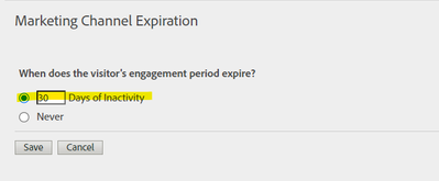

I modified the tracking code’s expiration time to match that of Marketing Channels. This got rid of "Unspecified" in the tracking code breakdown of every single channel other than Paid Search. Now, I need to focus on this channel and see whether my specific configuration is the issue with this channel. Thank you so much for all of your help! :)!
