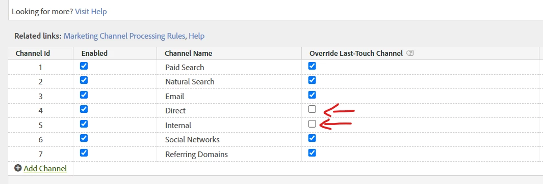

Context
  • Changes were made to our Marketing Channel Processing Rules a few years ago
  • Referring Domains was included in that change. Please take a look at the attached Marketing_Channel_Processing_Rules.JPG file
Issue
  • There is a significant amount of Typed/Bookmarked activity under Referring Domains. See workspace2.JPG file
Request
We need some help understanding why this is happening and any Marketing Channel Processing Rules configuration updates we need to make.

When breaking down Referring Domain by Marketing Channel Detail, I see almost half of the activity comes from an internal domain. It's worth noting that it comes in our pagename form. Please see attached screenshot.

@icontre1 Referring Domain overrides the last-touch channel in marketing channel processing rules. As a result, if a user came to your site via referring domains in previous visits and enters directly in the present visit, the marketing channel will be referring domain as it overrides the direct entry which is typed/bookmarked.
