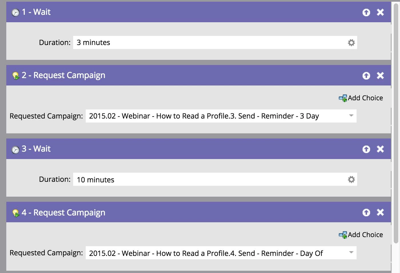

You can have a controller campaign when someone is added to the program that requests the three invite campaigns. Have a brief wait step (~10 minutes) in between each of the requests.

A short wait to allow data to synch back and forth from the webinar provider, then request the first reminder campaign, another longer wait, then the second reminder campaign.

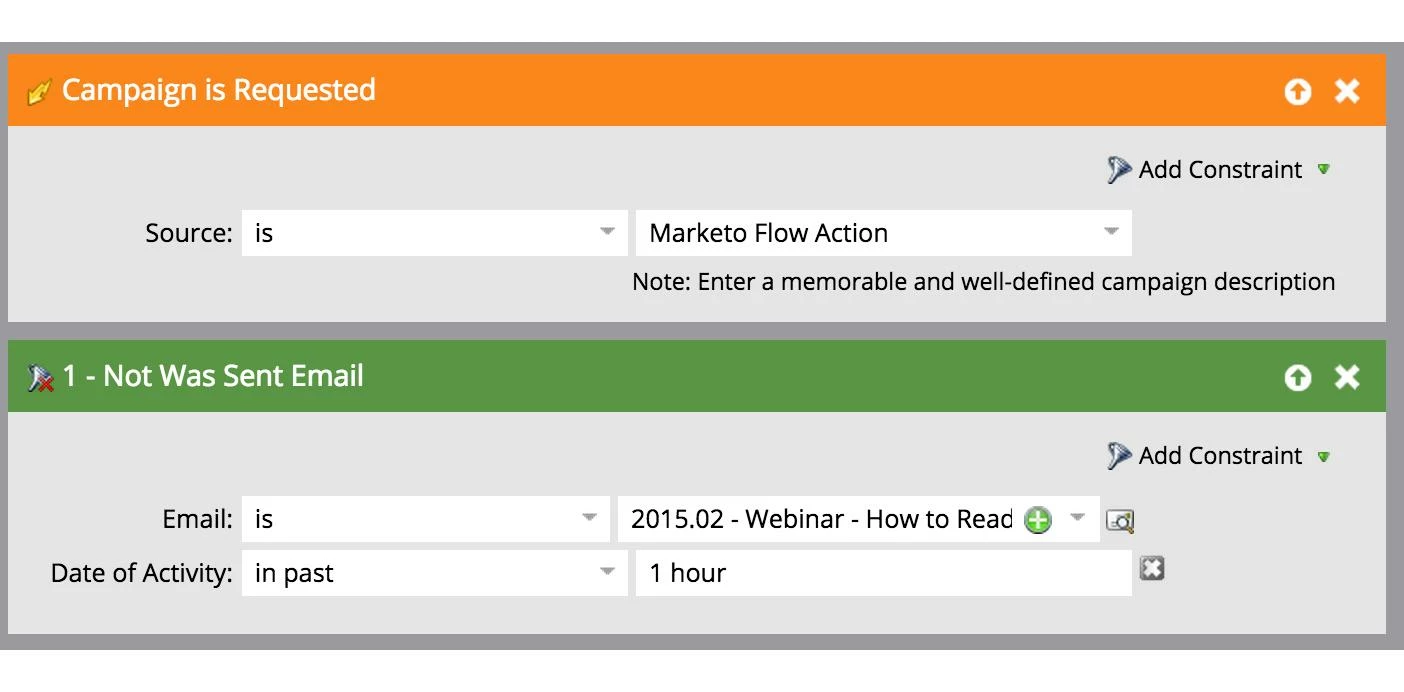

However, the second campaign has an additional filter in the smart list to prevent the email sending if the other reminder email has sent in the past hour:

Example of the controller campaign I use below -- I use it for reminders and not for invites but the logic could work the same.
