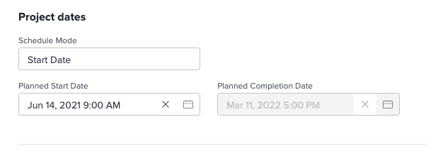

@Dan Ingham‚ @Paula Bailey‚ Here's the only other thing I know to check. When you set up the project, are you putting a 9 a.m. start time for all your projects? I know if we don't do that on ours, the times can be wonky.

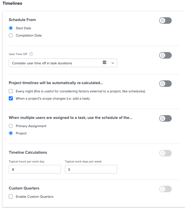

Ok - here's another thing to check that I think might help...
I went to Set up-->Project Preferences-->Projects
Scrolled down to "Timeline Calculations", and made sure it was set to 8 hours per day, 5 days per week.
Are you able to check that setting?
August 26, 2021
Our preferences are already set 8:5
Dan-Ingham작성자
August 31, 2021
Same here ours are set to 8 hours 5 days a week
August 31, 2021
Wow! So, for now it seems to be working. Something so simple, I hadn't thought of that. I'm going to keep testing to make sure, but it looks like it is working. Thank you so much! You never know when it may be the simple solution that could make all the difference!
