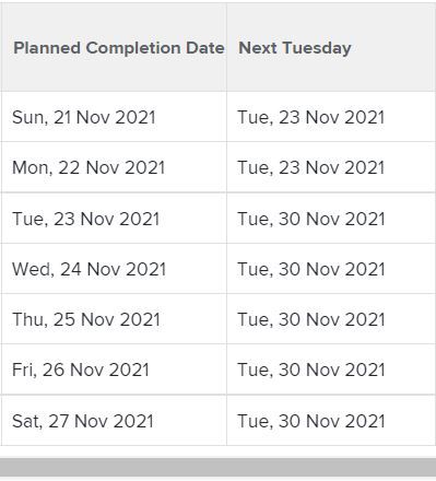

Hi Brittany,
It looks like something has gone wrong in the code when you changed it. In my environment using the original code, it works perfectly:
The code doesn't look at work days, just days in general. It should automatically work out what the next Tuesday is regardless of any non working days.

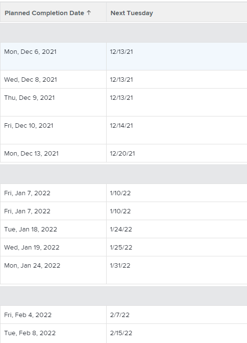

What you are seeing is your text that you gave me, not anything I changed. It autos to the Monday, minus one or two of them which have Tuesday. I had tried to change it to look at different days since it's looking at Monday right now. That's why I brought it up. I am not sure why your text is not showing up as Tuesday as it should on my end.
Hi Brittany,
That's bizarre. Strangely it's not a consistent issue either. In your screen shot you have a Wednesday planned completion date (8th Dec) that returns a Monday (13th Dec) in the 'next Tuesday' variable, which is incorrect. . . . . But you also have a Wednesday planned completion date (19th Jan) that does return a Tuesday (25th Jan), which is correct. I can't replicate that in my environment, i've tried using different schedules, assigning diffferent users, adding public holidays etc., but I always get a Tuesday.
Silly question, but I have to ask. Are you definitley referencing the native planned completion date attribute in the planned completion date column on your report? There's no way that this is using a date attribute that is different from the native plannedCompletionDate attribute (possibly a custom field that someone named as planned completion date)?
Best Regards,
Rich.
Sorry, I was out of office. It is the native planned completion date and not a custom field. I did double check that. It is very bizarre in the fact that it is coming up differently but in a random way as in there is no consistency to it. I am going to try it on a different task. Because this is looking at three differently named tasks in the filters.
We figured it out. The system was considering a task planned completion after 5pm as the next day and so the added days were off by 1. Once we moved it to be before 5pm, it worked perfectly.

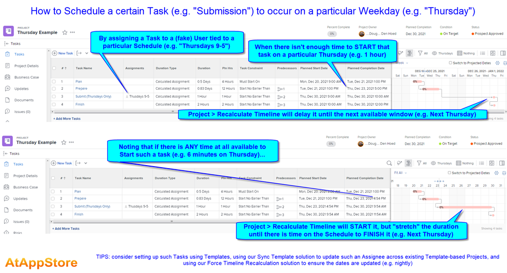

Huh...actually, @Michael Perez‚ and @Richard Leek‚, after some experimenting today, here is . . .
How to Schedule a certain Task (e.g. "Submission") to occur on a particular Weekday (e.g. "Thursday")
- By assigning a Task to a (fake) User tied to a particular Schedule (e.g. "Thursdays 9-5")
- When there isn't enough time to START that task on a particular Thursday (e.g. 1 hour)
- Project > Recalculate Timeline will delay it until the next available window (e.g. Next Thursday)
- Noting that if there is ANY time at all available to Start such a task (e.g. 6 minutes on Thursday)...
- Project > Recalculate Timeline will START it, but "stretch" the duration until there is time on the Schedule to FINISH it (e.g. Next Thursday)
BONUS TIPS: consider setting up such Tasks using Templates, using our Sync Template solution to update such an Assignee across existing Template-based Projects, and using our Force Timeline Recalculation solution to ensure the dates are updated (e.g. nightly)
Thanks for the cool thought exercise!
