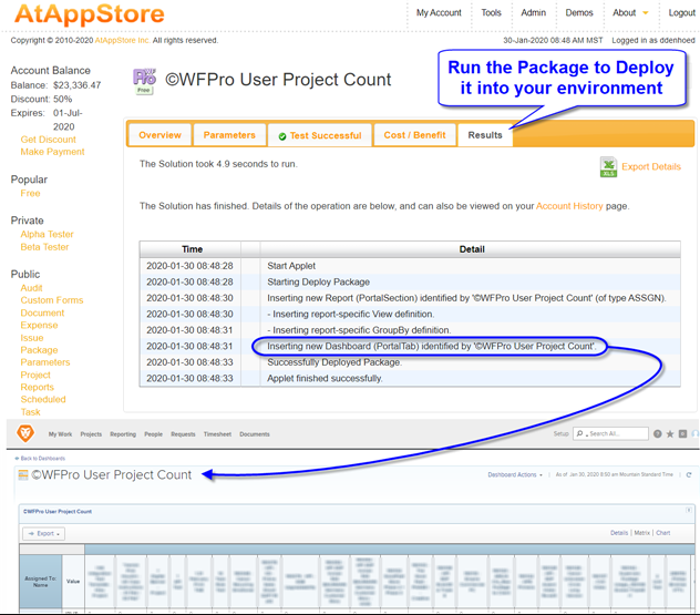

In addition to the tip from @randyroberts, I invite you to consider deploying this User Project Count solution (as below) which shows the number of Projects per User in grid mode, and the number of Assignments per User in Chart mode.
Doug

You'd think this would be simple, but it's not! Doug's solution was the best I found and it worked for us.
