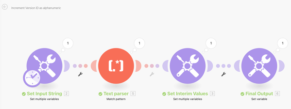

The answer here lies in splitting the number from the version code. This is easiest done with a Text parser using a regular expression. Then use the Fusion switch() function to select your next variable. The only issue here would be that you would be limited to the number of switch variants built out. Take a look at the attached blueprint export and it will show you all of the regex codes and formulas used. You can play with the input value and see the resulting version code.
Hi Andy - thanks for all that information! I'll definitely give it a shot and see how it goes. 👍
