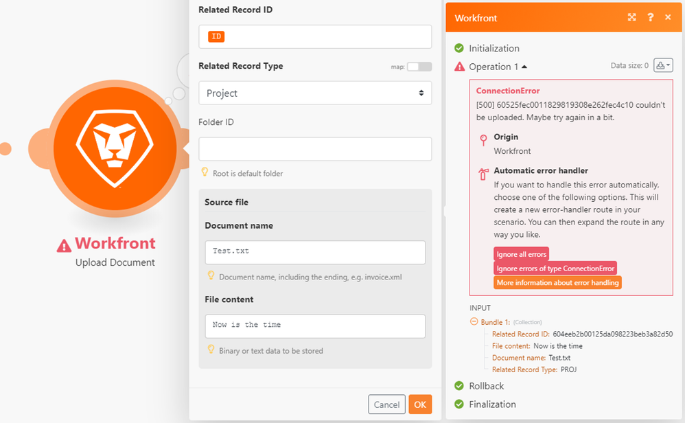

Anyone else experiencing problems with document upload in Fusion 2.0?
Level 8
Using the Fusion 2.0 'Upload document' module for Workfront and passing a valid project ID (confirmed), it takes a while for the red ring to surround the upload document module, then fails to upload a document.
There's not a lot of explanation in the output error, just that Workfront couldn't do it at this time. I'm pretty sure it worked a week ago, and now has stopped.

Hi Barry, that is pretty strange. I just mimicked exactly what you have without any problem. I'd be interested to confirm if you can upload file directly in the Workfront interface. If so, (and maybe if not), I think you'll want to submit a support ticket so that they can take a closer look. I even tried to think of all the different error conditions to see if I could reproduce the same error (using an invalid project ID or uploading to a project that is closed both produce different "rational" errors).

  • I built a two module scenario to find a known project and upload a document, pointed it to a different Workfront instance and it worked.
  • I then changed the connection of both modules and it failed.
  • I then logged into that instance as the user who has authenticated the connection and manually uploaded a document.
  • I checked under setup and the Workfront instance is allowing documents stored on Workfront
  • Support confirmed they could upload a document to another sandbox instance, so it's not that we're not using a production instance of Workfront
Working with support on the issue now.

good news is, you are not alone! we have exactly the same issue in sandbox on CL04. Bad news is a ticket is pending for the last three weeks or soand hasn't been resolved yet 😞

Thanks Chris. Testing took 30 seconds to confirm the issue is with sandbox and not preview. If we had of been told that when we logged the ticket, we could have shrugged our shoulders and moved on instead of waiting for days for support to confirm we're not idiots and the correctly configured module is failing, and then be left with no work-around.
