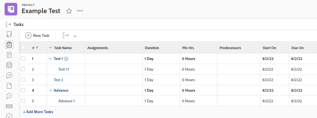

I am struggling to get this to work:
displayname=Test
listdelimiter=<div>
listmethod=nested(tasks).lists
textmode=true
type=iterate
valueexpression=IF(ISBLANK({actualCompletionDate}),IF({numberOfChildren}=0,IF(CONTAINS(" Test1 ",{name}),CONCAT({plannedCompletionDate}," - ",{name}),IF(CONTAINS(" Test1 ",{name}),CONCAT({plannedCompletionDate}," - ",{name})))))
valueformat=HTML
I am trying to pull a Task within a project that is named Test1 to a column in a project level report and see it's status, but when I do this the field is blank.
Thank you,
David

Project data
result
