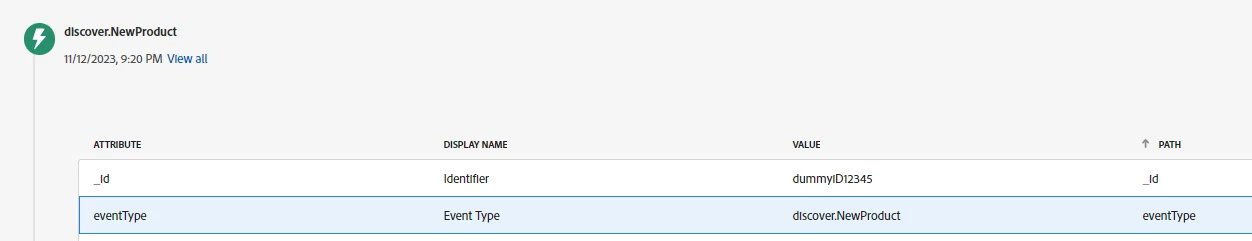

I streamed to AEP custom event like that:
When this event will be visible in configuration in order to create event based journey based on that?
Unfortunately it's not visible yet (it was like 2 hours ago).

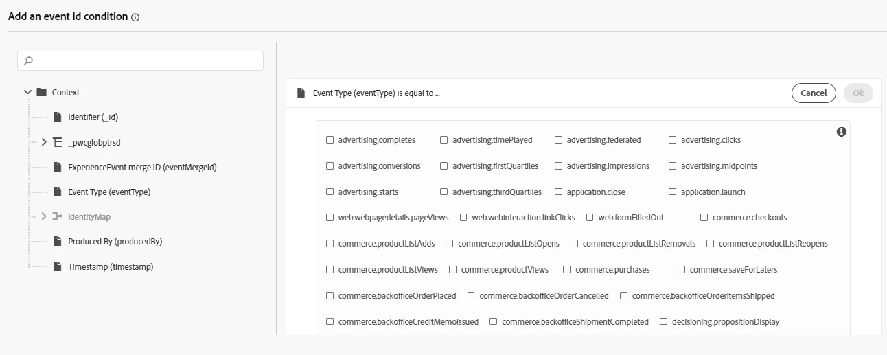

Best answer by Mohan_Dugganab
Kindly check if discover.newProduct value is added to the event type attribute as enum / suggested values (Reference - https://experienceleague.adobe.com/en/docs/experience-platform/xdm/ui/fields/enum
If so, try creating a new event and see if it shows up. As an alternative, you can use advanced mode to perform the comparison check by keying in the custom event type value
Ex:- in(@event{eventName.eventType}, ["discover.newProduct"])

@michael_soprano This looks like discover.newProduct custom event. Ensure you're using the appropriate schema containing the custom event and that it is enabled in the event configuration fields section. Also, check under _pwcglobptrsd if that custom event is showing or not.
Thanks, Sathees
