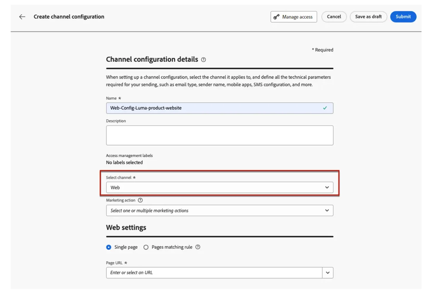

Hey! I'm building out a Campaign to run on my Web Channel, but can't set it to run on a specific URL, so it's going to run on every single page on the site. Alternatively I could create a Channel specific to the page I want it to run on, but that would mean a new channel for every page on my site, so we're going to end up with thousands of channels. Per 1:35 in [this video]  in the documentation, I can set the URL, however that interface does not show for me. How do I set it to run on a specific URL? Screenshots attached for what my interface looks like when setting up Channel and Campaign.

The video is from 2023 and previously, you can set up the web channel configuration directly into the Campaigns (at that time web channel was available only in Campaigns).
Now that web channel is also available in journeys, you have to setup the configuration under Administration > Channels > General Settings > Channel configurations

@colinra3 Looks like the web channel configuration setup is using "pages matching rule" setting. You can create a separate channel configuration depends on the needs and setup web campaign.
https://experienceleague.adobe.com/en/docs/journey-optimizer/using/channels/web/configure-web-channel/web-configuration
