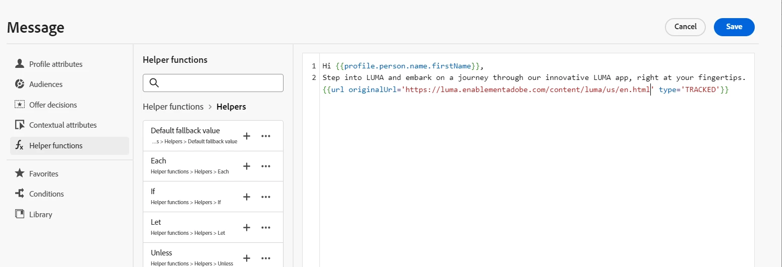

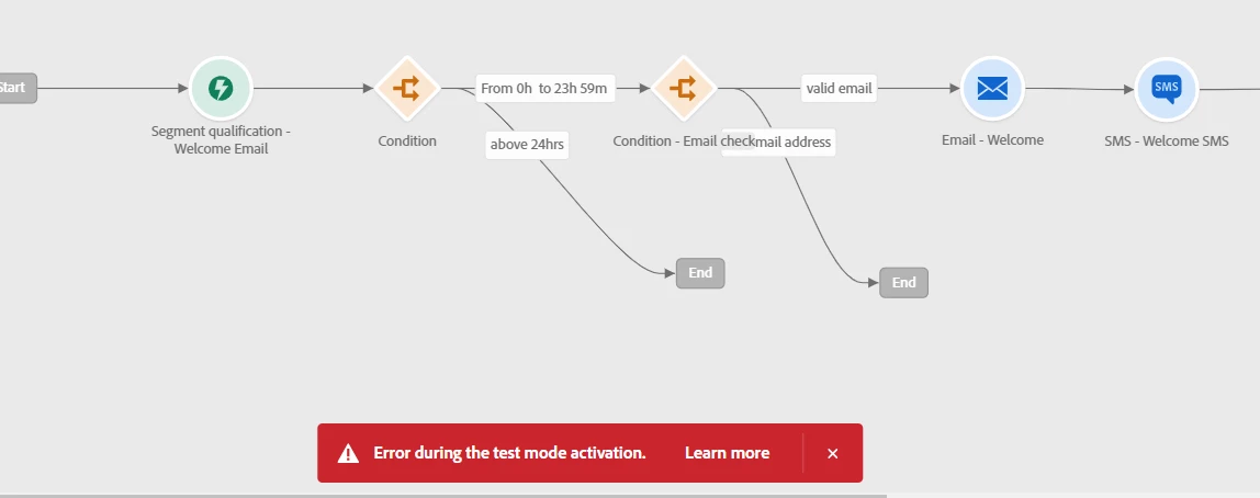

When I am trying to add a tracking URL in my SMS content and switch the journey to Test Mode I am getting below error.
SMS Content FYR
Note: I am able to switch the journey to Test Mode and send sms successfully without tracking url.

ベストアンサー SR10
Hi @satheeskannak ,
On further analysis we found that the subdomain delegation for SMS is not in place for our current AJO sandbox. According to the documentation a subdomain should be linked to the channel surface to use URL shortening function. Refer the documentation for more details.

Hi @satheeskannak ,
