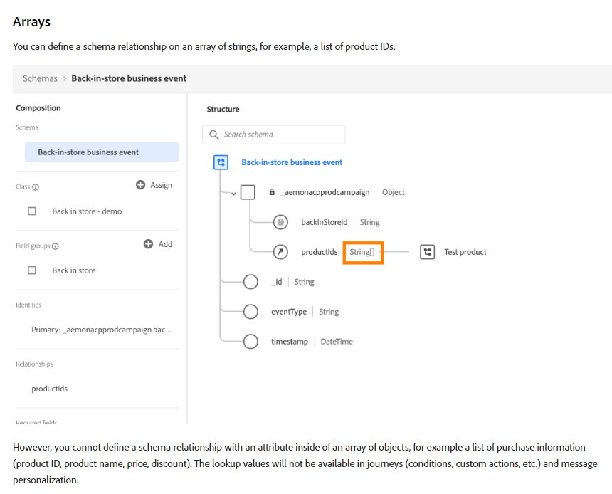

is it possible to retrieve the information from a relationship established with a lookup schema into a journey?
In the specific i have an id on a profile schema, this id is related to a lookup entity with further details, such es color, price etc. Can i retrieve the details of the lookup into a journey using for example the data in a custom action?

Thanks! however i have tried with a lookup related to a profile schema and this doesn't seem to appear in my custom action definition
@Mohan_Dugganab You won't be able to use the lookup schema in the custom action when you have read the audience/segment qualification based journey. If you're having a journey that uses event you should be able to see the lookup schema by switching to advanced mode .
Thanks, Sathees
right, the documentation link I pointed to, was referring to a schema of type XDM ExperienceEvent class indeed.
