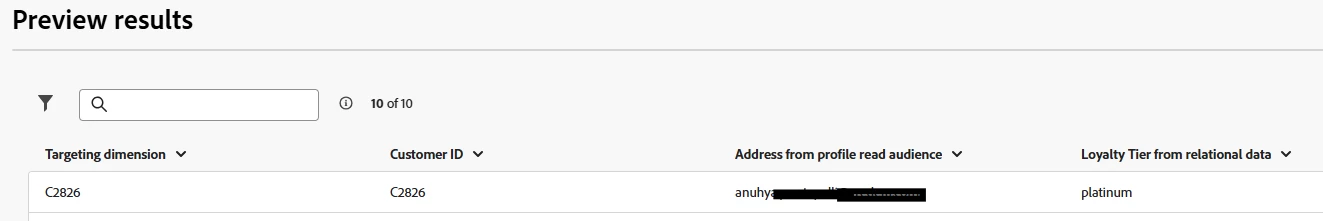

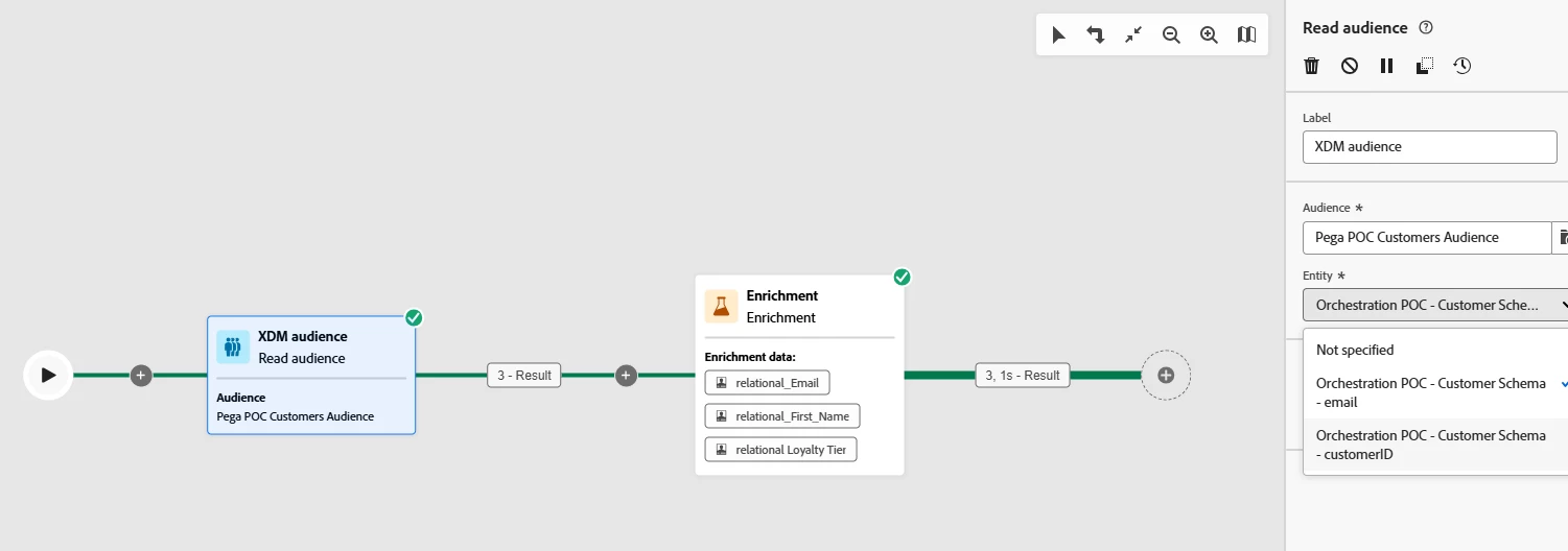

  1. In the Orchestrated Campaign canvas can we use a Read Audience activity using XDM schema data and enrich that using the Enrichment activity that sources non-profile-enabled model-based relational data?

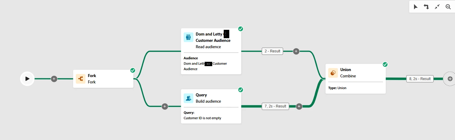

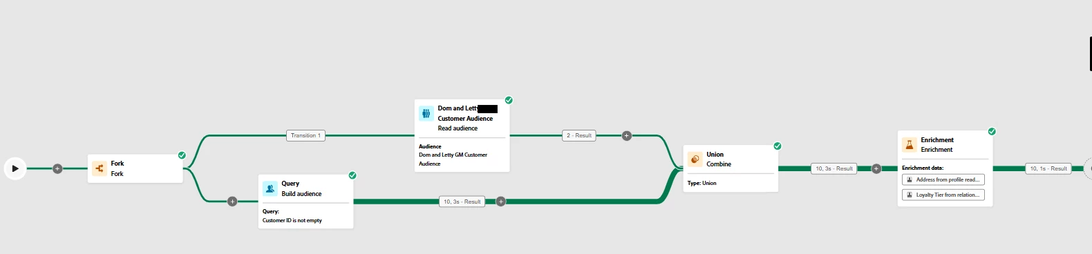

  2. In the Orchestrated Campaign canvas can we start with a fork activity where branch (1) goes to a Read Audience activity using XDM schema data, and branch (2) goes to a Build Audience activity targeting non-profile-enabled model-based relational data. And can these two branches then be combined (create a union) using the Combine activity?

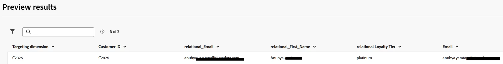

  3. In the Orchestrated Campaign canvas can we use the Build Audience activity targeting non-profile-enabled model-based relational data and then enrich that data with XDM schema data using the Enrichment activity?

  • In the Orchestrated Campaign canvas can we use a Read Audience activity using XDM schema data and enrich that using the Enrichment activity that sources non-profile-enabled model-based relational data? Yes
  • In the Orchestrated Campaign canvas can we start with a fork activity where branch (1) goes to a Read Audience activity using XDM schema data, and branch (2) goes to a Build Audience activity targeting non-profile-enabled model-based relational data. And can these two branches then be combined (create a union) using the Combine activity? Yes
  • In the Orchestrated Campaign canvas can we use the Build Audience activity targeting non-profile-enabled model-based relational data and then enrich that data with XDM schema data using the Enrichment activity? Yes
