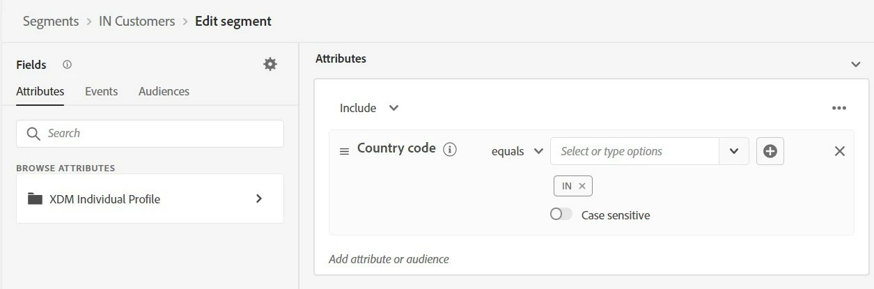

Segment details:
Segment Name: IN Customers
Criteria: HomeAddress-->CountryCode eq "IN"

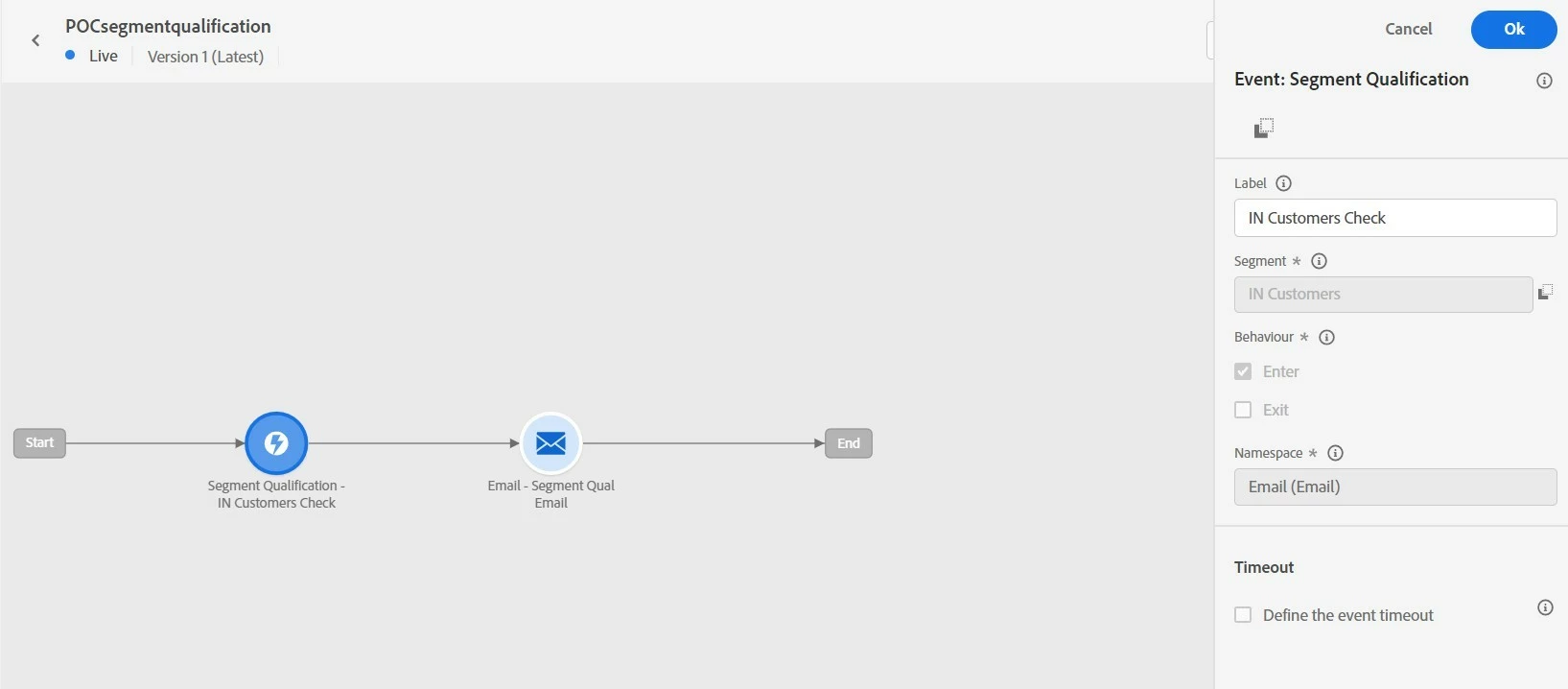

Journey Details
Journey Name: POCsegmentqualification

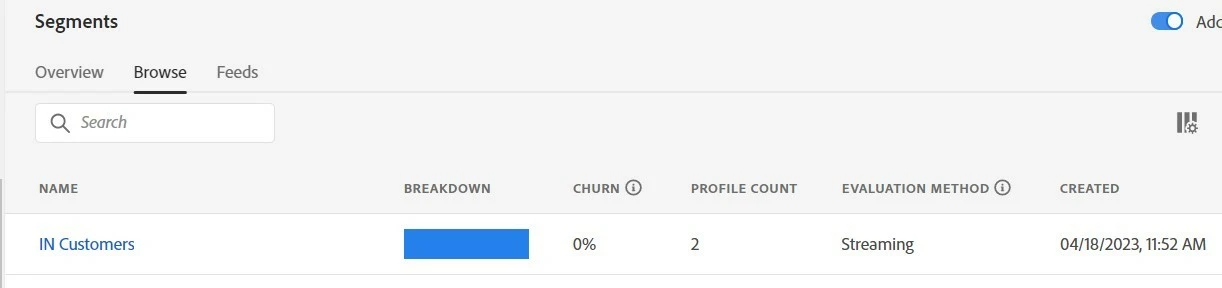

We are able to see data in segment

  • Did you test this journey using test mode while in the draft state and did that work?
  • The screenshot shows that segment type as streaming. Ideally, profiles will pass through the journey as they qualify for the segment. Did that two profiles count on the segment added before Journey was live?
