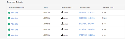

Hi Lukas,
The output generation is successful. Please find below
We are using this metatopic details in the page source code.
