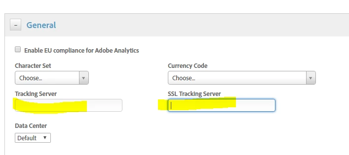

Hi all,
I have one web property that has 3 domains. Each domain has there own first party cookie tracking server (secured and unsecured). I assume I can write an if statement in the custom code area of the adobe analytics tool so that the tracking server will change based on the domain. Does that mean I should leave the tracking server fields under general tab blank? Also, is there another maybe easier way, to get the same result?

ok, I figured it out. I leave the fields blank in the general tab and specify using the below code for each secured and unsecured tracking server wiithin my if statement.
    s.trackingServer="tag.somethinghere.com";
    s.trackingServerSecure="securedtag.somethinghere.com";
works perfect.
