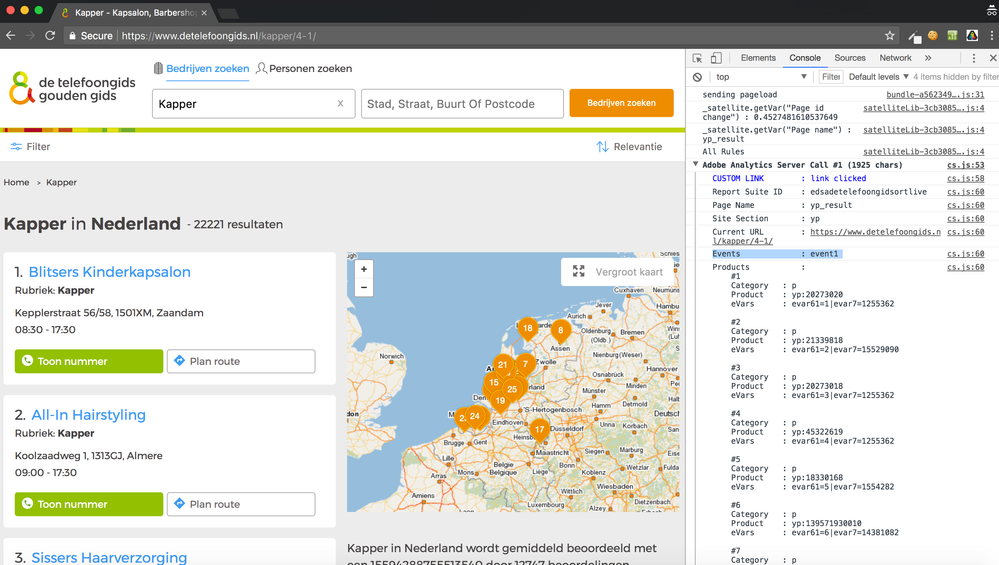

Please find the steps and URL as under-mentioned :
  • Open the new incognito mode window in Chrome browser.
  • Make sure  chrome plugin “Adobe Analytics Debugger” is on in incognito mode of chrome.
  • Hit the search page URL https://www.detelefoongids.nl/kapper/4-1/  directly into URL bar.
  • Observe the logs of “Adobe Analytics Debugger”  in console of Chrome Developer tool.
  • There are 4 server calls seems fired. Out of these 4, first 2 calls of "Adobe Analytics Server Call" are duplicate and "Adobe Analytics Server Call #1" & "Adobe Analytics Server Call #2" are the exact same rule, with same data and with same “Events : event1”.
  • Please have a look at 3 screen-shots attached for further reference.
This issue seems not only in incognito mode, but also in normal chrome window. In case if you are not able to generate this in normal chrome window, you can try with incognito mode of chrome to reproduce the issue.
When I load your page using the method you mentioned, I'm seeing 4 different server calls. I've highlighted the difference in the first two call since you indicated they were duplicates:

Do you have a rule that set's the Unique ID?
Here is a list of the rules that I show as firing on the page:
Rule NameRule TypeFired?Other Info
0AA: page loadEvent Basedyesdataelementchange(Page id change)
AA: listing impressionsEvent Basedyesdataelementchange(Page id change)
AA: search result pageEvent Basedyesdataelementchange(Page id change)
I assume one of these rules or somewhere in the Analytics tool itself, you have code setting the unique ID.
Hope this helps,
Jantzen

Hi Dejan,
When I look at the page using an incognito browser and the steps provided, I'm seeing two requests in the network tab for that call. The first is a 302 redirect which is used to set the s_vi cookie. The second is the 200 which is the actual beacon being sent to Analytics. This is expected behavior and shouldn't be viewed as a duplicate beacon.
If I understand your test correctly, you are correct. Having a bounce rate of grater than 0% proves that there is not a duplicate beacon on that page. If there were a duplicate beacon, it would be near impossible to have a grater than 0% bounce rate because every visitor would have at least two beacons.
Hopefully, this answers your question. Please let me know if you still have concerns.
