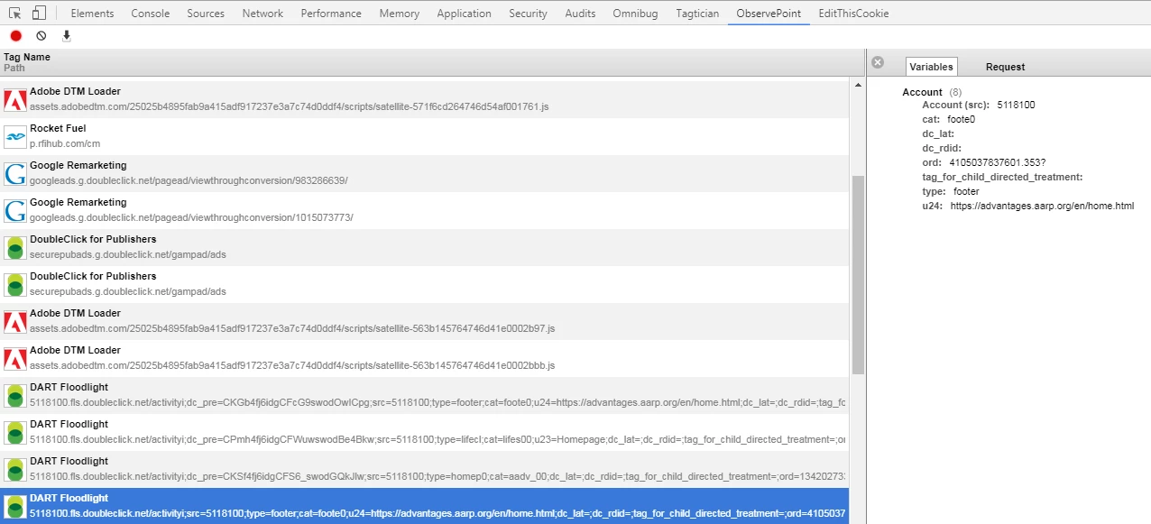

We have implemented a DTM rule to fire our floodlight tags. We are using a Page Load Rule and a Sequential Javascript:
var axel = Math.random() + "";
var a = axel * 10000000000000;
var b= _satellite.getVar('PageURL');
document.write('<iframe src="https://5118100.fls.doubleclick.net/activityi;src=5118100;type=footer;cat=foote0;u24=' + b + ';dc_lat=;dc_rdid=;tag_for_child_directed_treatment=;ord=' + a + '?" width="1" height="1" frameborder="0" style="display:none"></iframe>');
However, when we debug, we notice that there are two tags that fire with a minor difference:

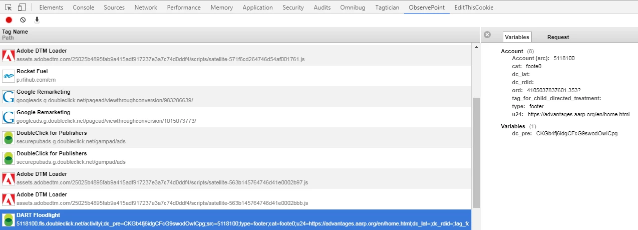

One tag has the following variables:
and the other fires without the dc_pre variable:
Is there a reason for this? Is there a way we can do away with the other tag fire? What is the dc_pre variable?
Any help would be appreciated.

aseelund
December 18, 2017
The first one is probably a 302 redirect, check to see if that's the case. The second would result in a HTTP Status code of 200 if this is true.
If so, this isn't firing twice or duplicating data, its just redirecting in google.
December 18, 2017
@joshd7227840 and @aseelund
Thanks so much. I think the link shared and @aseelund's answer are pretty much the same explanation. Thank you very much for clearing this out for me.
