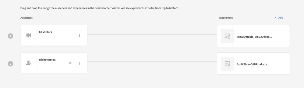

Do I have to create an audience with the profile script for each of the experiences?
Or can one audience be placed in both experiences? See screenshot for reference.
