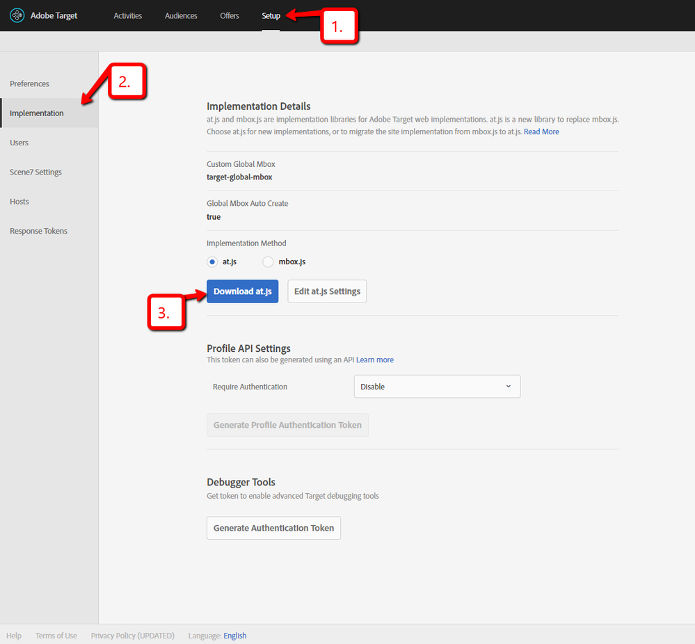

Here is more detail on how to download the latest version of at.js code (See screenshot below):
1. Log in to Target
2. Go to Setup > Implementation
3. On this page make sure you have at.js selected
4. Click on Download at.js
