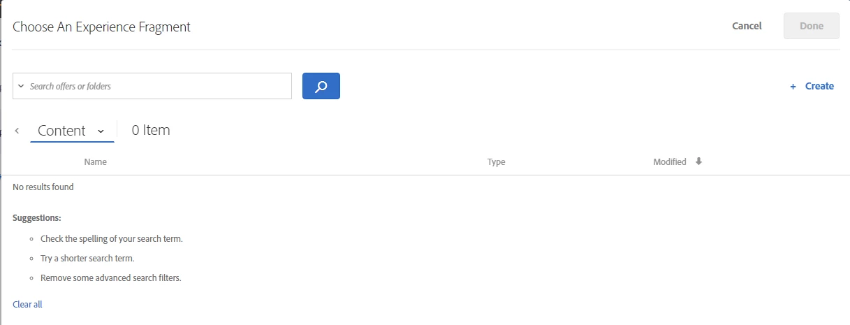

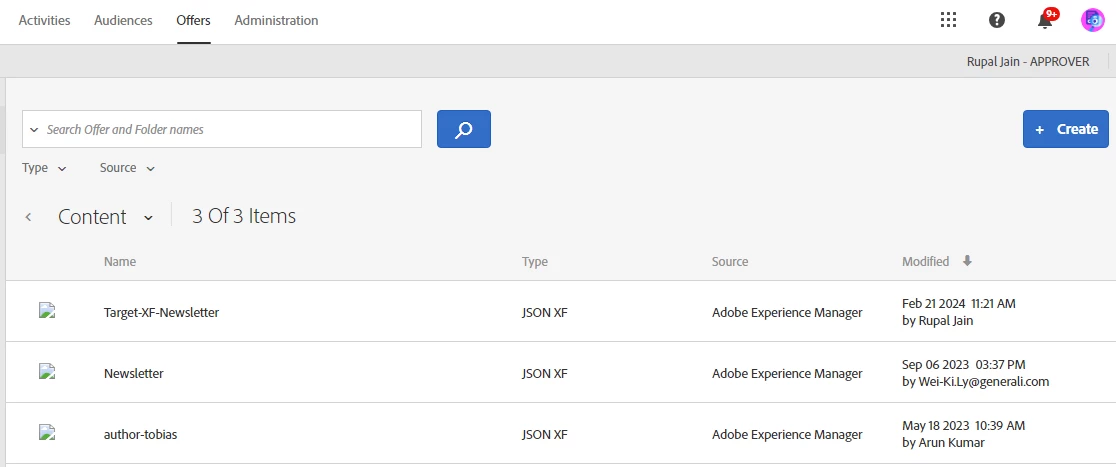

Dear All,
We are using AEM cloud and have been able to export the experience fragments from AEM to Adobe Target. They show under Offers inside Adobe Target. However, when I create an activity, and try to replace the content with Experience Fragment, it shows 0 results.
Has anyone else facing the same issue? Is there anything I am missing ? Please find below the screenshots -
Many thanks

How are you creating your Target activity? If you're creating it via the Visual Editor then you would only see HTML Experience Fragments when using that "Replace Content > Experience Fragment" option
February 22, 2024
Dear @alexbishop ,
Yes I am using VEC Editor. Do you mean any of my components which have clientlib or JS code wouldn't be visible?
If not, then how can I utilize those?
jainrupal2408AuthorAccepted solution
February 26, 2024
I found the root cause. While exporting the Experience Fragment, I need to make sure it is exported in "HTML" format. This can be done by selecting export format either "HTML" or "HTML&JSON" .
Once HTML version of XF is exported and seen in Offers tab, then it can be used in VEC.
