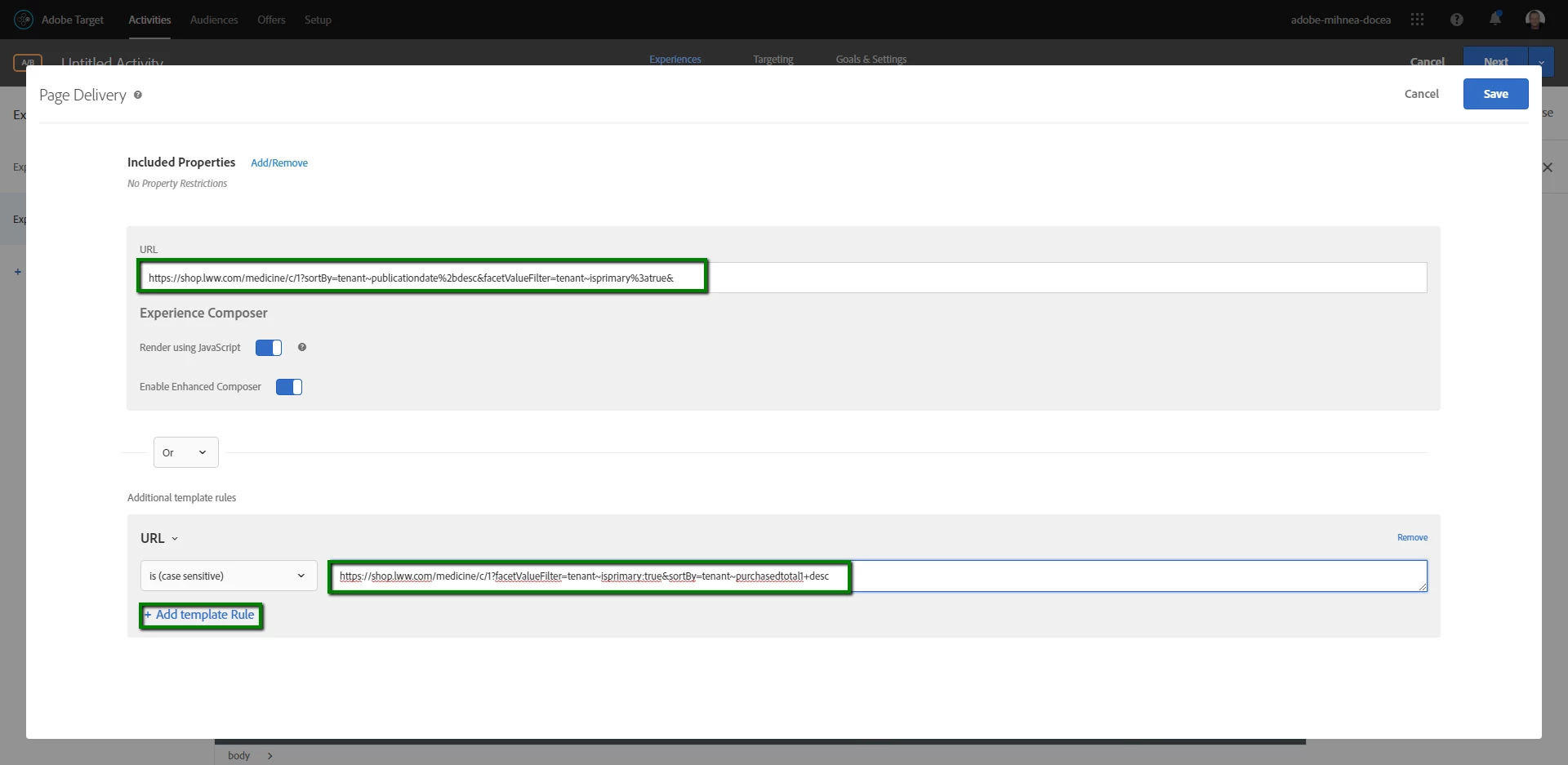

I would switch back to A/B activity type. In regards to your previous statement: "I have tried setting up as A/B test, but the page delivery only allows for a single URL." That is not completely accurate. While you will only be able to designate one primary URL you do have the ability to specify additional URL parameters (By clicking "+Add template Rule") that can satisfy the URL requirement take a look at the screen-shot below where I demonstrate how to set this up. Additionally instead of is you can use contains to cast a wider net.
Given the requirement: "I want visitors to either of these two URLs to qualify into the activity."
URL1: https://shop.lww.com/medicine/c/1?sortBy=tenant~publicationdate%2bdesc&facetValueFilter=tenant~isprimary%3atrue&
URL2: https://shop.lww.com/medicine/c/1?facetValueFilter=tenant~isprimary:true&sortBy=tenant~purchasedtotal1+desc
I would define the Activity URLs like this:

Thanks @mihnead.
My challenge is that each URL will have its own variation. I want to see how all visitors will react to each version of the URL being the default selection. Basically, how do I test two different URLs of the same page? Experience A is URL 1 and Experience B is URL 2.
March 5, 2020
I discovered that I could set the existing default page to redirect to the desired page in the second experience. This resolved my issue.
