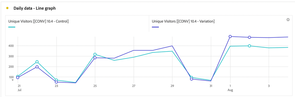

In my case, this is the overall data (see screenshot below).
10.410.4
You can see unique visitors differ considerably. and when i input the unique visitor data into the CXL calculator, it flags an SRM error.
This is the daily data for the same experiment. You can see the data was fine up until August 1st, which is when the SRM error started appearing
10-410-4
