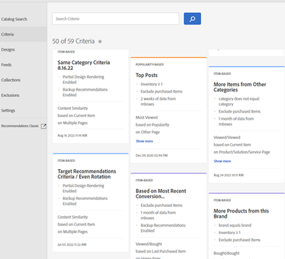

Hi! I am trying to create a recommendations activity to show recommended articles on a blog based on the article a visitor is currently on. My criteria is to look at the current category ID and show other articles w/ same category. I believe the best way to set this up would be an items with similar attributes algo, with current item as recommendation key and the content similarity using entity.category. When I create the activity, I am unable to find/select that criteria I created. In fact, out of the 59 criterias I have, I can only see 26 within the activity even though I've made sure the activity and criteria both use the article and category page types. Please assist, thanks!

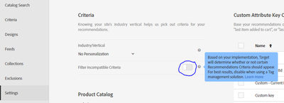

Hi @bwilson704
to resolve this go to recommendations settings and turn on filter incompatible criteria. You will be able to see the criteria.
Hope this helps.

Really appreciate the response! The issue is that I don't have any filters selected and the max I can see is 26, even though my total criteria inventory is 59.
Hope this helps.

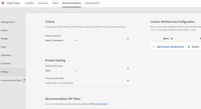

I have same issue as @bwilson704 I don't have any filters selected and the max I can see is 28, even though my total criteria inventory is 58. Also, I am not able to see "Filter Incompatible Criteria option" in recommendation settings. Please assist, Thanks!
Hi @SD20 ,
Am facing the same issue as you stated above i.e.,not able to see "Filter Incompatible Criteria option" in recommendation settings.
