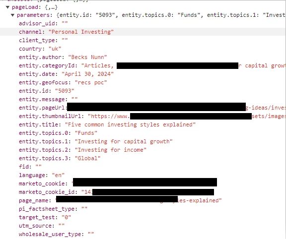

Hi all, I have observed quite a strange behaviour. I am sending product information using a similar method to below. Products can be found using advanced search, but after approximately 2h these products disappear from catalog. I am populating the entity.geofocus property to enable segmentation (setting to "recs poc").
I can't figure out what is causing disappearance. Example of the payload is provided below. I would appreciate if some could help me to figure this one out. Thank you.

So an interesting observation in here - only first product instance is being passed on to catalog. The product appears to be identified by "entity.id". Any subsequent product instances with different entity parameter values are being removed. Example:
- we make a product request with the "entity.id" = 5093 and "entity.geoFocus" = "UK"
subsequent product request with
- we make a product request with the "entity.id" = 5093 and "entity.geoFocus" = "DE"
Only the first instance appears in the catalog. ie product instances (with slightly different entity prameter values) are not being retained in the catalog. This observation is based on my testing. Would be good if someone could confirm this behaviour.

Hi @kandersen, I see that the original value "entity.geoFocus" = "UK" being preserved while subsequent hits (with "DE", "IE" etc.) are shown for about 2h and then they disappear from catalog. If I perform search the next day, the initial instance ("UK") is being returned in the catalog. Instances where geoFocus was set to "DE", "IE" etc. are missing.
I did some more testing - I manually emptied the catalog and then send some more hits. The only way to record a hit is to remove the old one manually.
Regarding the value not being preserved. Can you rule out that someone else is sending in updates with the UK value?
I don't see a scenario where the system rolls back to the previous/original value. However, it is a classic case that if you're testing in production and you're changing settings to DE and then afterwards someone else visits the same page but with the UK value - this will then cause what you're experiencing in the catalogue, as they will be sending a new update entity.id after you updated it to the DE value.
Even if you're not testing in production, do someone else have access to the test environment who could be sending in the UK value.
