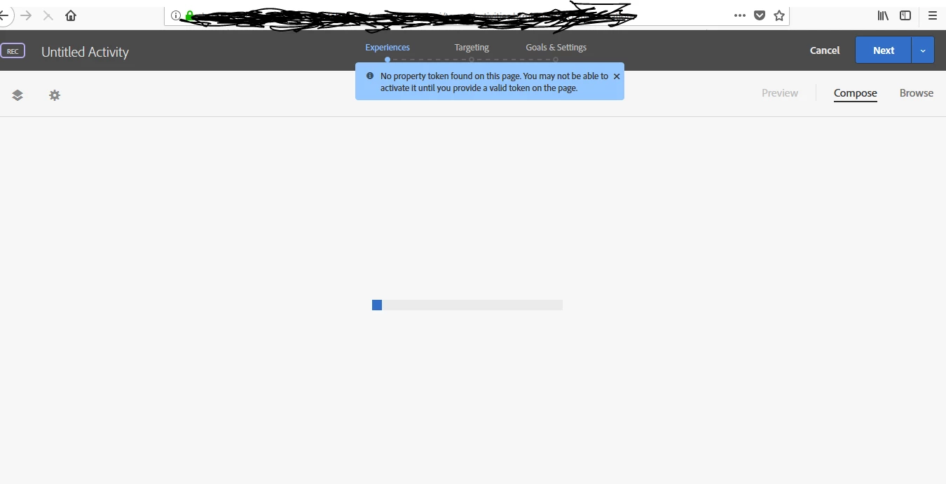

We are new to Adobe Target so not sure what this error means, when we try to create a Recommendations Activity pointing to DEV environment AEM URL, we are getting “No property token found on this page. You may not be able to activate it until you provide a valid token on the page.” Can someone please help in resolving this, below is the screenshot attached for the same.

Yash1709,
You have two options on how to fix this. You will have to navigate to the following location: Target > Setup > Properties
Option1: Delete the URL from the properties list.
Option2: Edit the property get the special property code and add it to the page code on that URL.
Both of these will make the error go away. If you can't figure out how to do it and are a supported user reach out to client care at: ttclientcare@adobe.com or 1 (800) 497-0335 x3

Hi Yash,
Please check whether you have embed your DTM/Launch Akamai code to your DEV url.
The error "propertey" mean here is the domain which we are adding in DTM/Launch.
Mohanrao
Yash1709 Could you clarify if you are using workspaces or enterprise permissions ? In that case you will need to pass the at_property parameter in your implementation.
