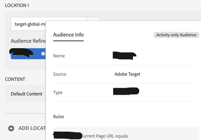

For the Location Audience Refinement, I set the audience as "URL equals <my home page>"

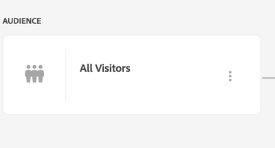

For the Targeting step 2 of Edit Activity (Experiences step 1, Targeting step 2, Goals & Settings step 3), I have no audience defined (it is the default All Visitors)
Hi jpetermarias,
I believe I am qualifying for the segment because I am able to see my experience content on the page. The issue is that when I click any link on the page (linking to other pages), the URL changes but the entire page content is "stuck" on the experience content (pressing F12 shows the Activity response is still present even though the URL changed so it was supposed to navigate away from the experience page).
Screenshots attached below.
