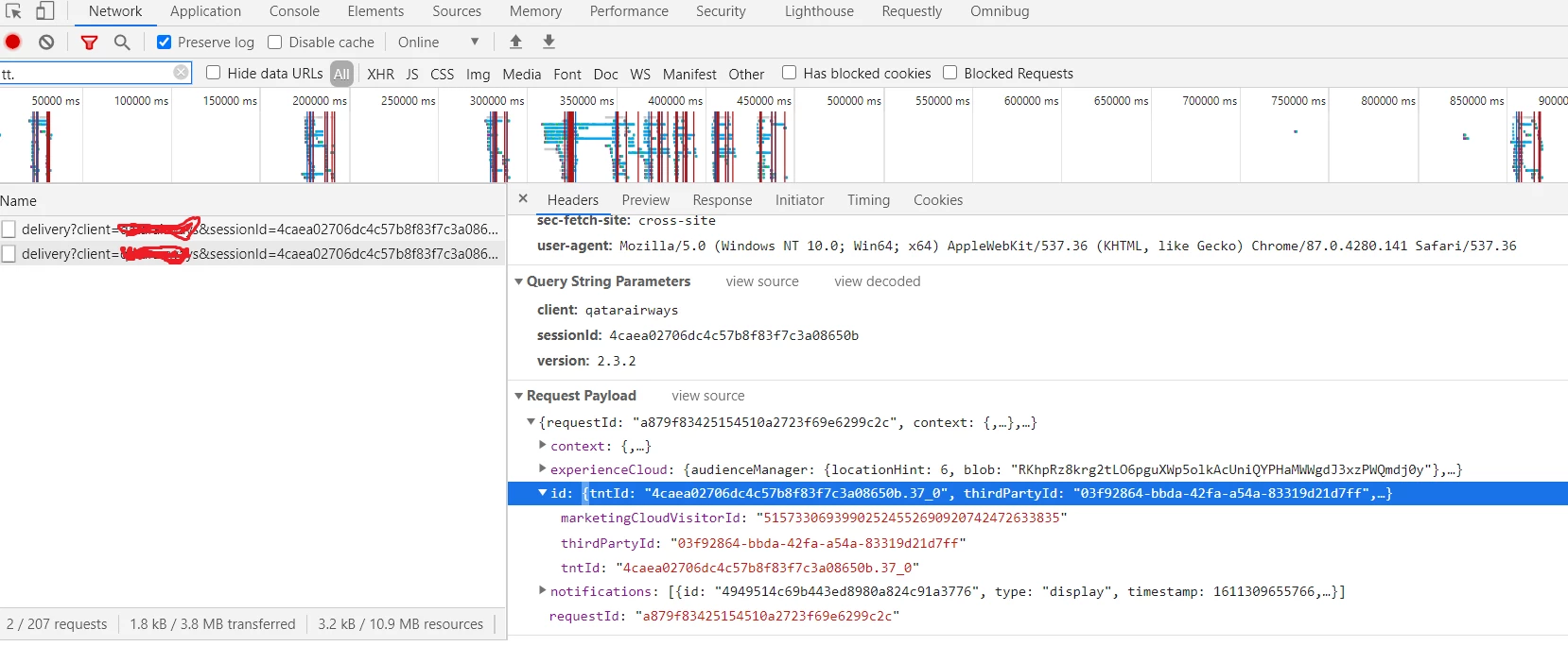

We are uploading the offline data into experience cloud using CRS.  The website is on at.js 2.x , we have passed mbox3rdPartyId through  adobe.target.trackEvent  through Adobe Launch Rule "PQR".
Target is implemented on website through launch only and there is separate rule "ABC" for this.
"PQR" is firing post "ABC" and I can see call is firing in network tab for both.
I can see mbox3rdPartyId also present under Id.
So wanted to check with you if this setup would not cause any issue and I can target the loggedIn users since I have the thirdPartyId in the param.
