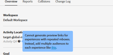

I understand that Target have provided an "Activity QA" URL which appends parameters to the site, however depending on how the Target's activity / experiment is setup, the "Activity QA" URL might not be available. For instance, if the activity is set to have one initial audience, but each location is filtered down again based on difference audience criteria, with this config we're unable to get the QA URL parameters. Most of the published/activated experiments are already configured in a way where the "Activity QA" URLs cannot be used. Screenshot attached below of what it currently shows for me.

However not all experience have the "Activity QA" url. As mentioned depending on how experiments/activities are configure the URL parameters might not be available.
Screenshot attached, which show this is not possible for me. I was hoping someway to clear some cookies or anything that's possible from the browser in this case.
