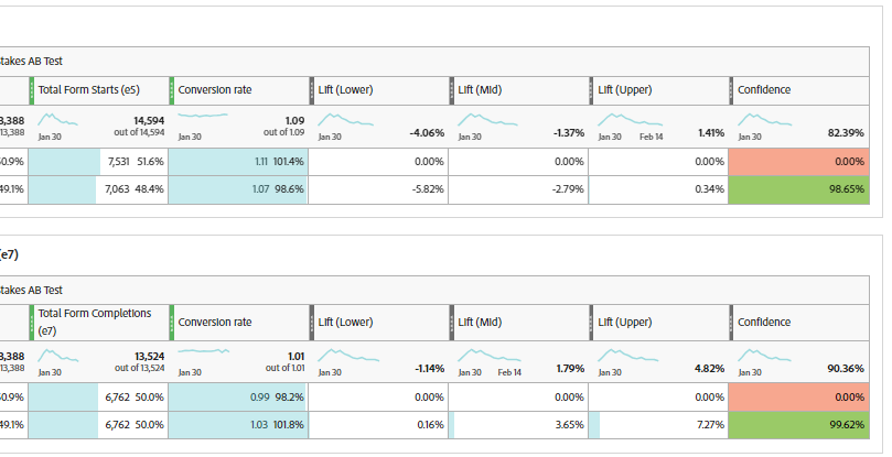

So I am trying to standardize the way my company is trying to ready ab test results.
The main question I want to know is:
Do we read the overall significance OR the % given at the target experience level?
66% or 93% ?
Best answer by alexbishop
You would read the individual experience level confidence % and then compare that against the confidence level that is set. By default this is 95% but you do have the option to export results data and adjust this (as mentioned here). It's also important to calculate the required sample size before starting the test, and checking that the "winning" Experience has met that sample size requirement, as part of validating the test results
RamizJaAuthor
February 15, 2024
So if I am operating at a 95% confidence level how would I interpret these results?
I have two metrics that I care about and they both have seemed to reach 95+ confidence levels.
The reason why I care about these two significances is because I want to both metrics in my calculations of a conversion rate = Total From Completes / Total Form Starts

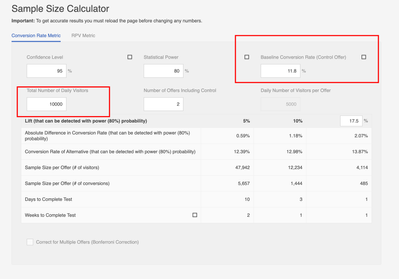

Thank you! That is helpful! I will keep the practice of following a single KPI for my sample size calculations and then keep with that to end the tests.
Follow-up question:
How do you calculate the sample size using the Adobe calculator accurately?
https://experienceleague.adobe.com/tools/calculator/testcalculator.html
-How do you decide on the baseline conversion rate and the total daily visitors?
-What is an example of a good page I should be using for the daily visits?
-Also for the conversion metrics baseline, what is a good way to get these metrics for our single KPI?
      normalizing for different behaviors because of months, campaigns, etc.
The Baseline Conversion Rate will be the current conversion rate (Metric/Visitors) for the Metric that you're optimising against. So if your test hypothesis is focused around increasing Form Starts, then you would take Form Starts/Visitors to find your baseline conversion rate. As you mention, you should take into consideration seasonality, ongoing promotions etc when deciding what lookback window/period to use to calculate this number
For the # of Daily Visitors, this should be specific to the page that your presenting the activity/offer on; this input is going to affect the number of days it takes to reach a statistically significant result, so it's important for the broader planning/prioritisation of the optimisation programme
