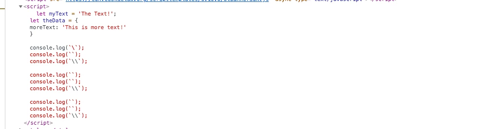

Screenshot of what gets injected into the HEAD by Adobe Target when preview link is loaded;

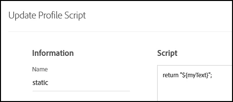

  • Create a profile script that returns the string you want returned like:
return "${myText}";​
  • Use the dynamic data sytax in your HTML offer to replace content with the value of your new profile script (I named mine "static").
    • HTML in offer example:
<script> let myText = 'The Text!'; console.log(`${user.static}`); </script>

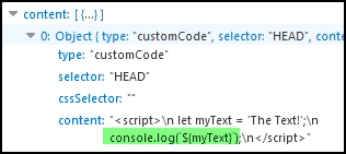

When I run this my response from Target returns this:
And I see "The Text!" printed to the console. There may still be a better way to do this. But maybe this will help you out until you find the better way.
