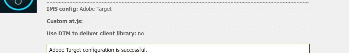

Hi All, I am trying to upgrade my at js version for a website running on AEM. I have integrated it with target via cloud services.
Upon browsing for the custom at js file that was downloaded, the changes do not get persisted. May I know if there is any other way to do this or it is  glitch.
The custom js field remains empty even after several saves.

I believe you followed https://experienceleague.adobe.com/en/docs/experience-manager-learn/aem-target-tutorial/aem-target-implementation/using-aem-cloud-services
It appears to be just UI issues. What you should check is :
  1. Are you able to successfully do "Connect with AT"
  2. Upon applying configuration on the page, do you see at.js loading.
If those are working fine, integration is good to go.
