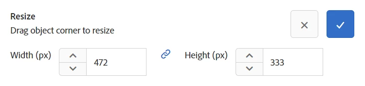

Is it possible to use Adobe target to resize images on the homepage ? If yes, what are the steps ?
Thanks.

Hi vinc112,
Yes you can resize image in VEC.
Steps to Resize:
1. Open site in VEC. Select Image that you want to be resized.
2. Click on Layout then resize
3. Once you click on Resize option will appear to change the Width and Height:
4. Click on right click to save the changes.
Reference document: https://experienceleague.adobe.com/docs/target/using/experiences/vec/viztarget-options.html?lang=en
