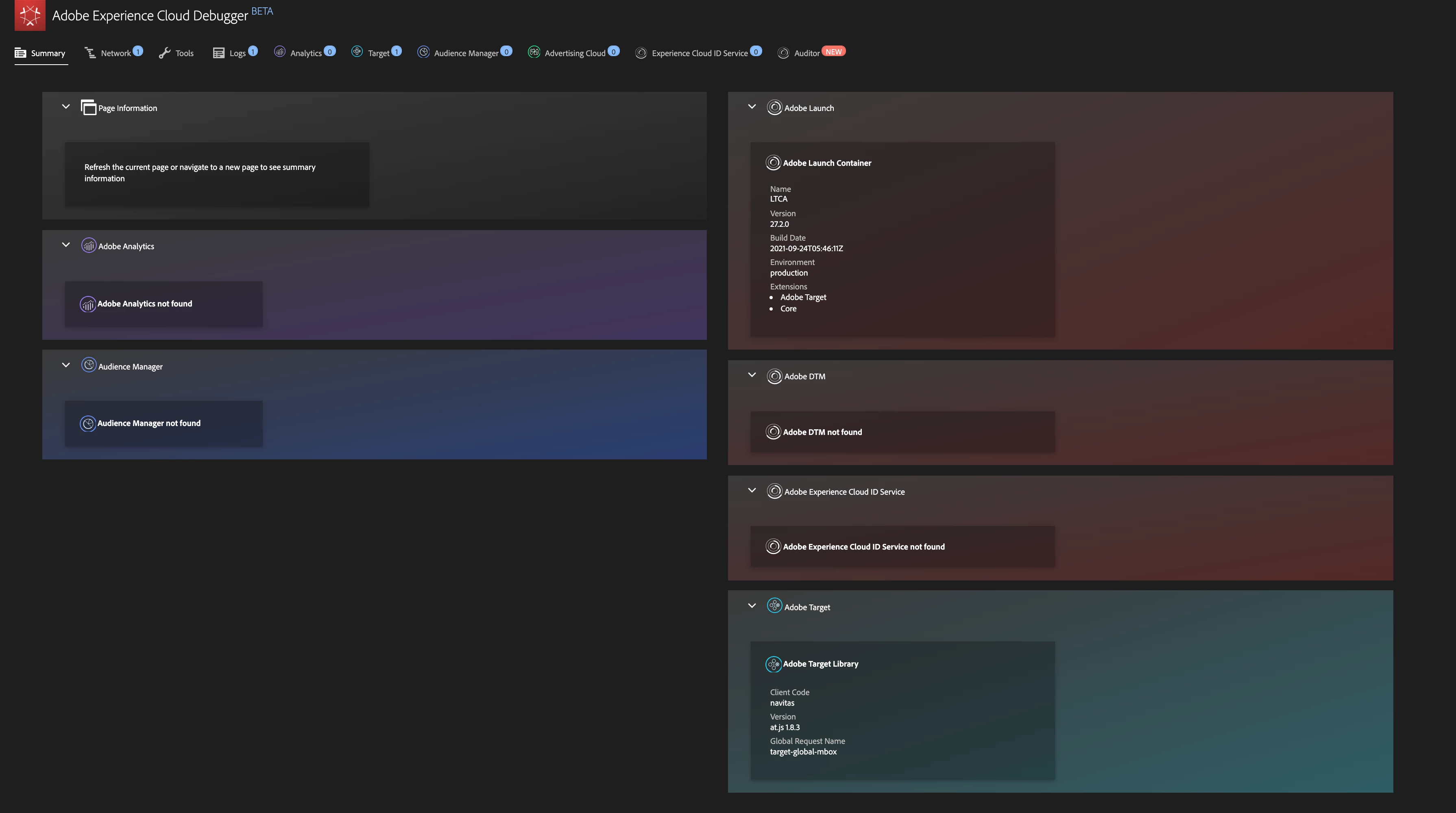

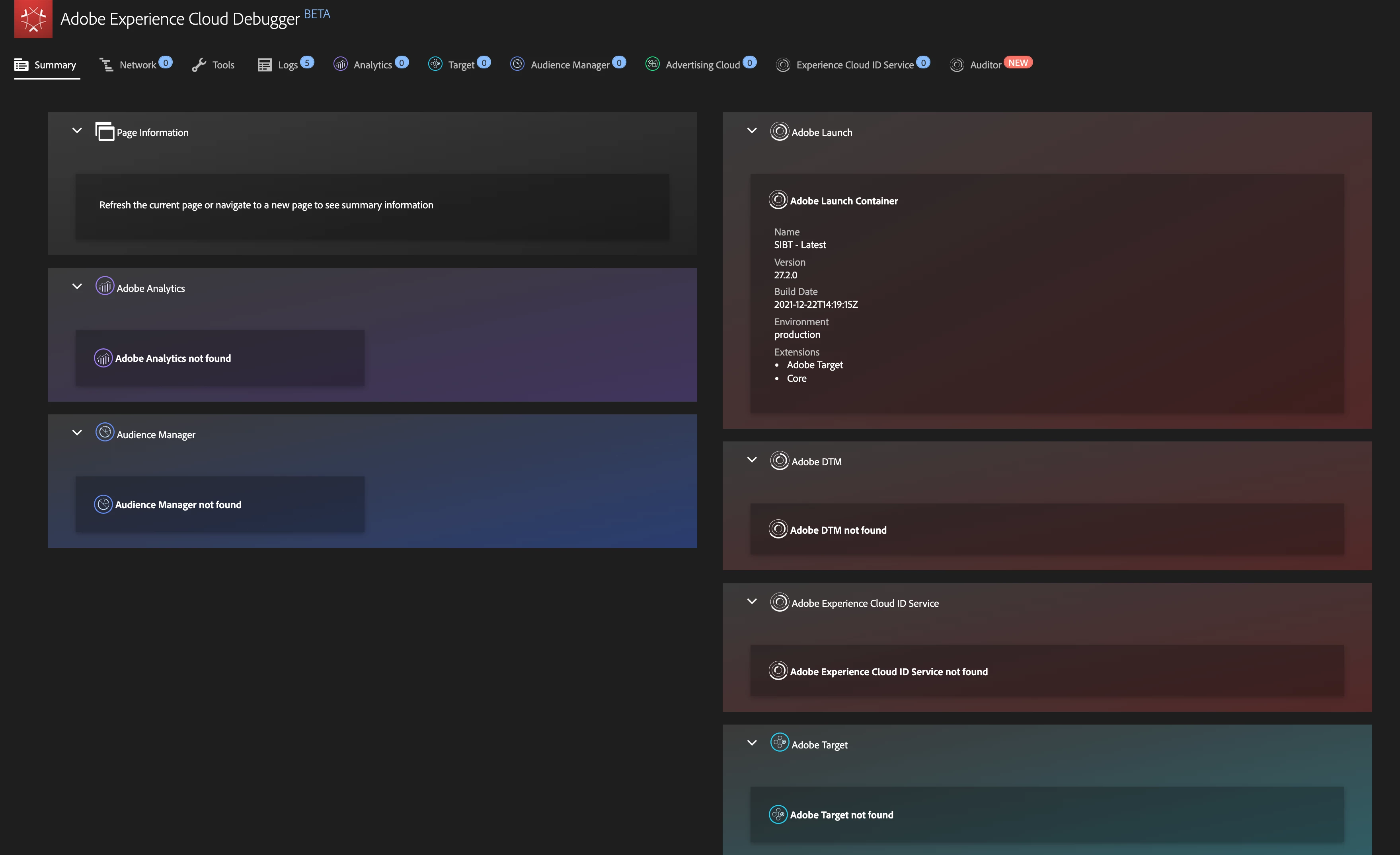

We have implemented the below adobe launch script on the website - https://www.sibt.nsw.edu.au/
<script src="https://assets.adobedtm.com/2e0c42a84c98/4eb827cd88c3/launch-c64cdad65965.min.js"> </script>
<script type="text/javascript">_satellite.pageBottom();</script>
However Debugger is showing Adobe target not found....
We had implemented Adobe Launch on another website in the same way and the target is loading fine - https://www.latrobecollegeaustralia.edu.au/
Could anyone help with this...

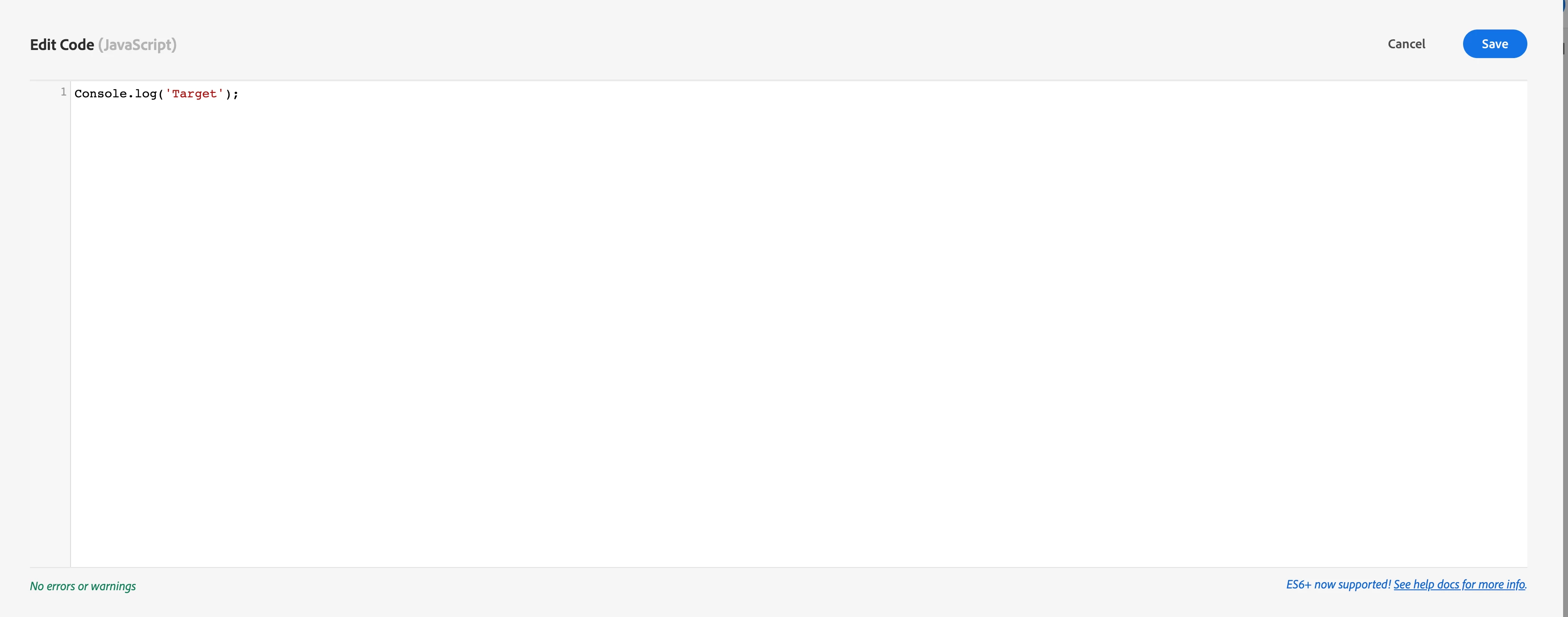

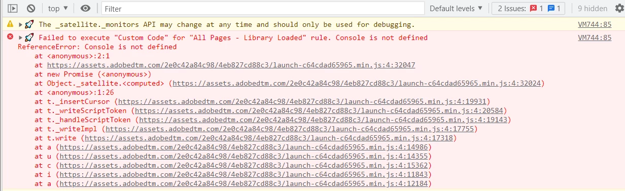

https://www.sibt.nsw.edu.au/ - Looks like there's an issue with 'Custom code' in the All pages - Library Loaded rule, specifically in the line which has "Console" - screenshot below:

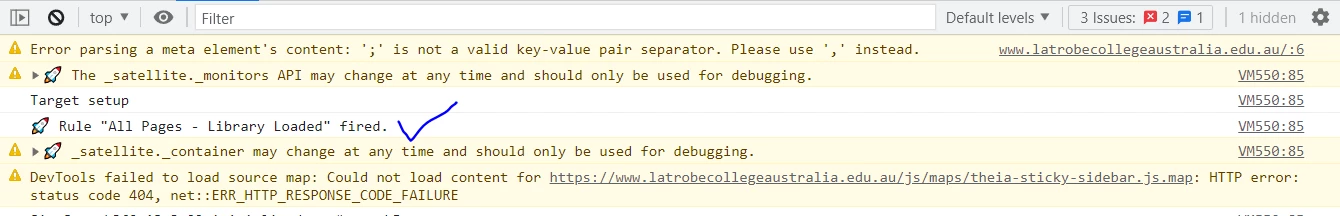

I could see that the same (or similar rule) is firing as expected on https://www.latrobecollegeaustralia.edu.au/

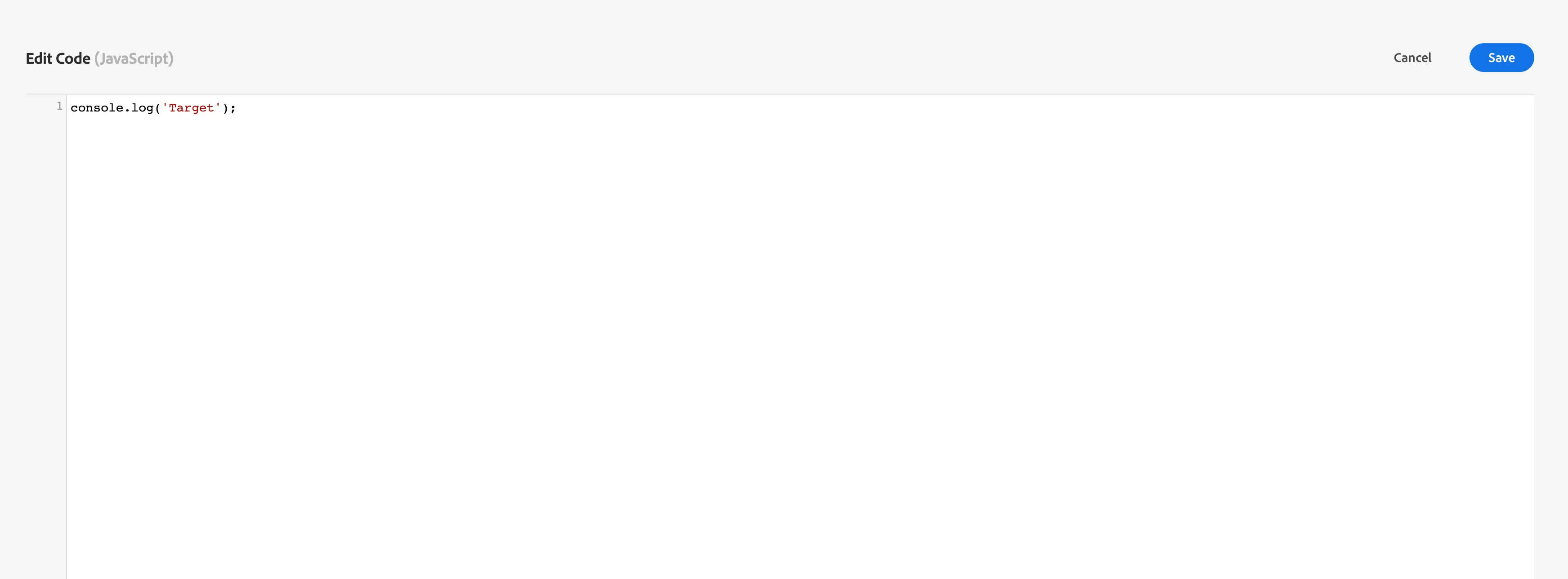

Hi @kishore_reddy Thanks for the quick reply. I checked the custom codes on the rules on both properties and there is some difference..
Our target developer had written these custom codes so not really sure why they are different. Will updating the custom code (https://www.sibt.nsw.edu.au/ ) to the same as on the website  https://www.latrobecollegeaustralia.edu.au/  resolve the issue?
