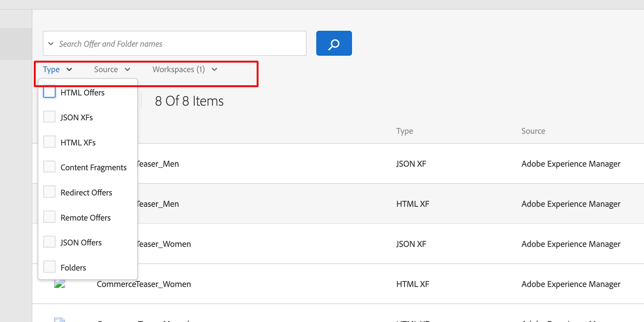

It should work with JSON XF. You need to ensure that the
  • Check-in code offers and ensure no filter is selected in target.
  • Experience fragment is exported as JSON from AEM, which can also be configured at the folder-level properties in AEM. After configuring, you need to ensure it's exported into target.

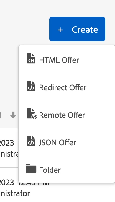

Also, You can directly create JSON offers in the target itself. Follow the below steps.

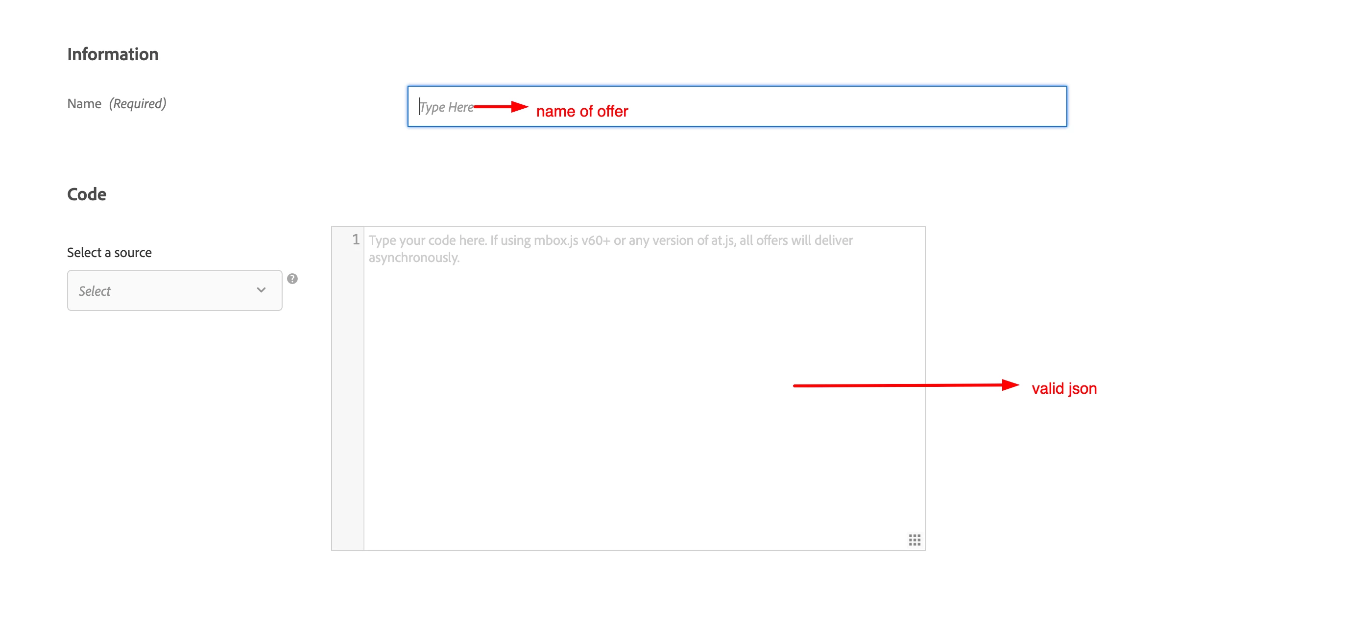

  • Go to the offer tab click on Create and select JSON offer
  • put the JSON and name of the offer and click save.
