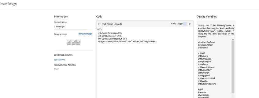

Hello guys,
I am getting this answer from AT recommendation as Most Viewed Entity
"user.endpoint.mostViewedEntity": {
"value": "{\n \"ranksByEnvironment\" : {\n \"0\" : [ ],\n \"1702\" : [ {\n \"id\" : \"\",\n \"rank\" : -2\n }, {\n \"id\" : \"Product A \",\n \"rank\" : 65\n } ]\n }\n}",
"modifiedAt": "2021-06-10T02:26:25.653-04:00"
How can I use this value in the Design because it seems it is not in the possible attribute can be used?
Yet, How can I add entity element to my JSON?

I'm not following your question. Can you clarify where the "answer" you are seeing is coming from. When you say how can I add entity element to my JSON, which element or attribute are you referring to? Any single-value attribute sent to Target for an entity can be used in a design.

Ok, My goal is to have an HTML recommendation answer with this information entity.id,entity.name and entity.message have been uploaded via Data Feed. My issue is I dont have this information in the answer from Adobe Target Recommendation. Currently I am using the  criteria below
