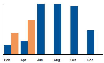

Can you share how to draw the Y-Axis lines? I am able to show the label on the X-Axis but am unable to show the lines on the Y-Axis. Please help. Thank you.
See example below:
Thank you
