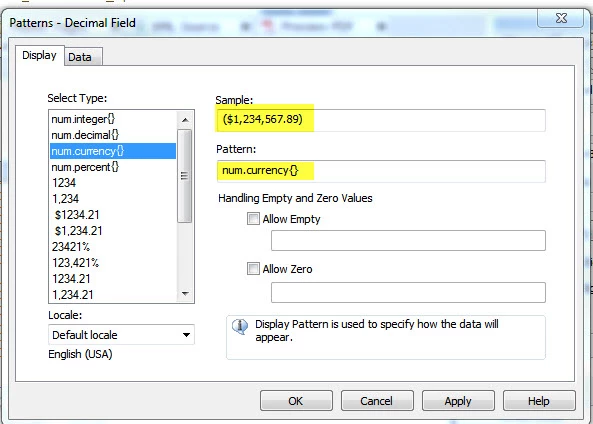

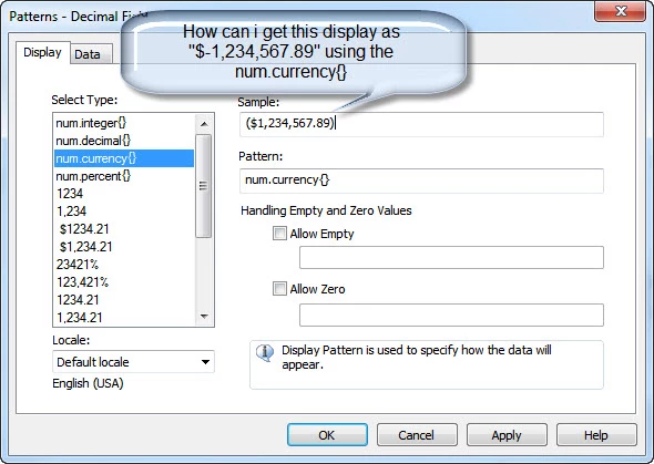

Hi Adobe folks,
I am working on a Adobe invoice form, where in few currency fields might need to show as "-" if it is negative number.
I am using Display pattern num.currency{}, but its displaying it as ($1,234,567.89), I want this to display as $-1,234,567.89
Can anyone please let me know how to achieve this.

I can use num{$z,zzz,zzz,zzz,zz9.99} to make it display -ve sign, but that defeats my main purpose, which is formatting the amount as per the Currency code. (For example if its USD it prints with 2 decimals like 22.33, and if its Japan currency, it prints without decimals 22)
That's the reason i wanted to use num.currency{} but want to print -ve numbers without braces.
Any help in achieving the "-"ve sign instead of "()" using num.currency{} would be highly appreciated !!
