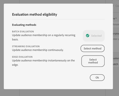

Until recently you did not have an option to choose the type of evaluation but this has been recently added within the UI.  

I say usecase because, you could create a segment from web events which could be edge segments but may not be really required/compatible for your destination. In this case you could change the type to batch.
