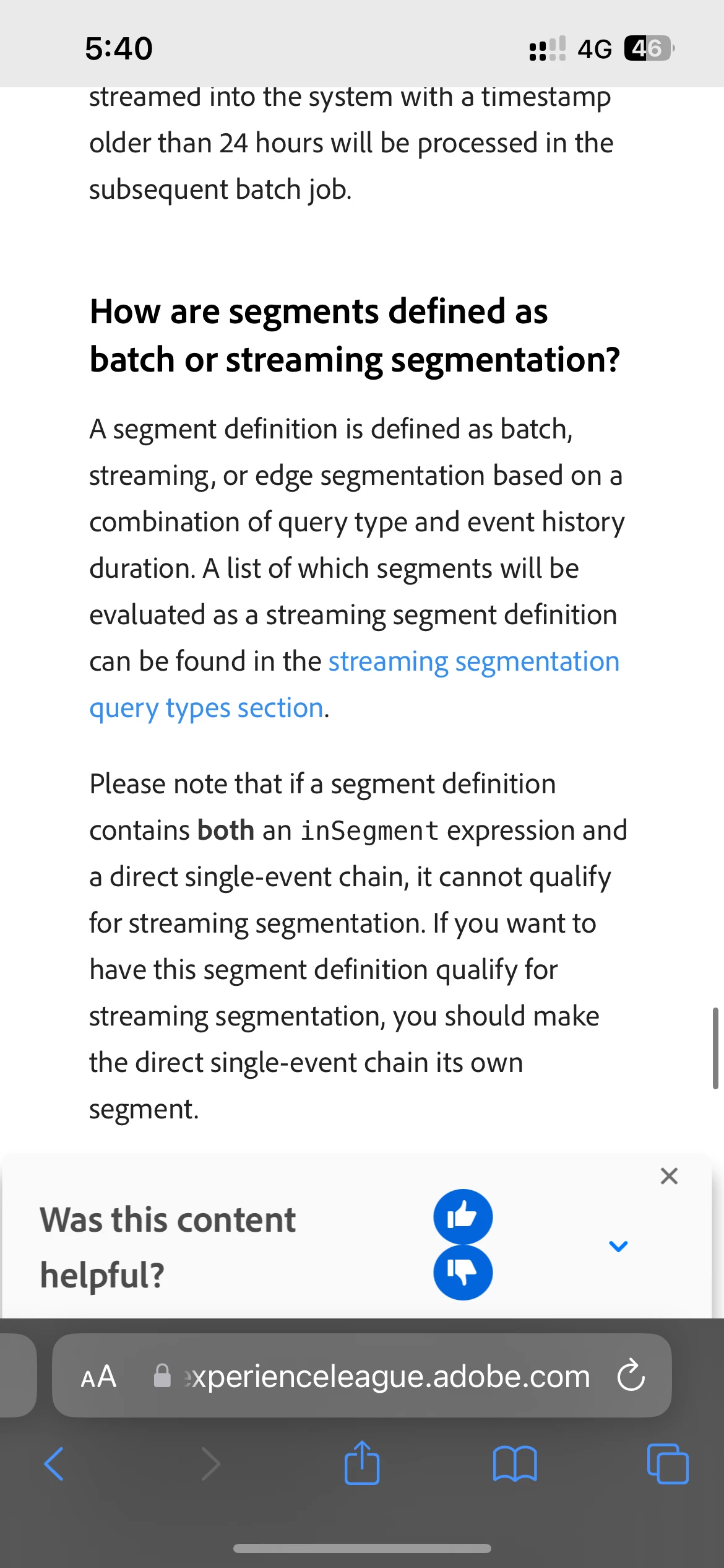

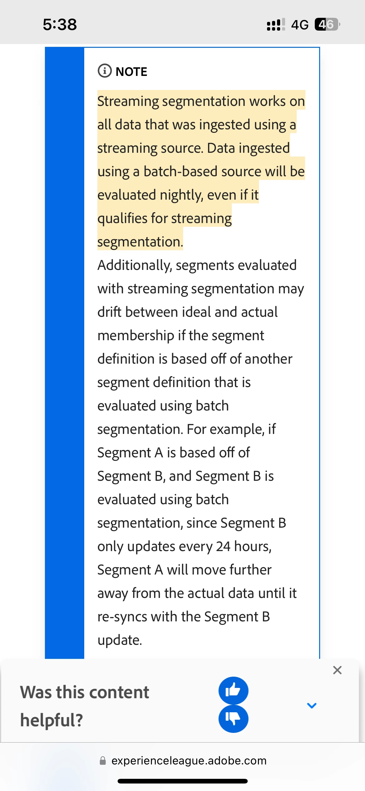

You can make a streaming segment based on batch data but it will not act as streaming. Cause the data would be processed in a batch manner i.e 24 hours. So even if you set a segment as streaming in the UI, in essence it will not behave truly as streaming. In some instances, if your data is based on a batch source, it may so happen that even if you set a segment to streaming, AEP may revert and set it to batch.
I would suggest to also have a read of this link: https://experienceleague.adobe.com/docs/experience-platform/segmentation/ui/streaming-segmentation.html?lang=en#:~:text=Streaming%20segmentation%20works%20on%20all,it%20qualifies%20for%20streaming%20segmentation.

I found this article really helpful in understanding segment/audience evaluation.
https://blog.developer.adobe.com/understanding-segment-timing-in-adobes-real-time-cdp-60e19558347a
"Batch data can be used in a streaming segment, but the ingestion of batch data does not trigger segmentation."
