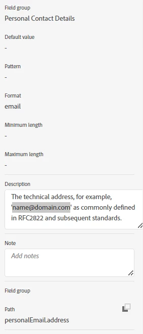

Hello @shaini_gupta , in past I had faced the same issue while using OOTB field and the reason is email format. As you can refer, "personalEmail.address" requires value in email format. (Refer to description in the below SS for more details)
As a workaround, if you can put some Dummy data (EmailUnavailable@email.com), then you will be able to ingest without any failure. To do so, you can use the below calculated field while ingesting data:
iif(matches_regex(personalEmail.address,"[^null$]" ),personalEmail.address,"EmailUnavailable@email.com")
