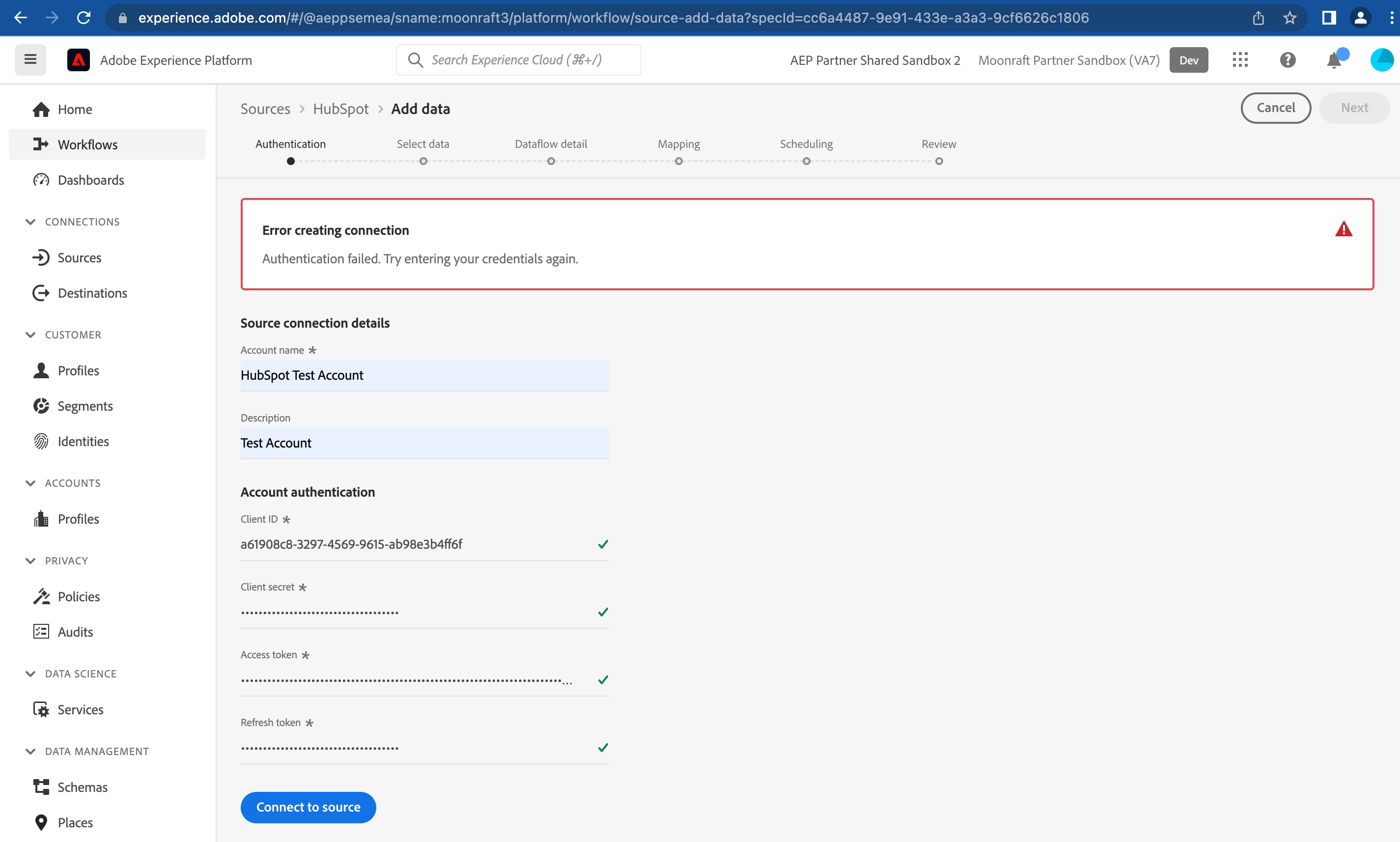

I am trying to get data from Hubspot to AEP. We have source connector in AEP to establish connection with Hubspot. Here is reference : https://experienceleague.adobe.com/docs/experience-platform/sources/connectors/marketing-automation/hubspot.html?lang=en
In this they mentioned about IP allow list. But not sure, where to add that IP allow list. Please of this IP allow list, the connection is not getting established I think so. Here is my error screenshot
Can anyone help me out with this error?. Thanks in advance

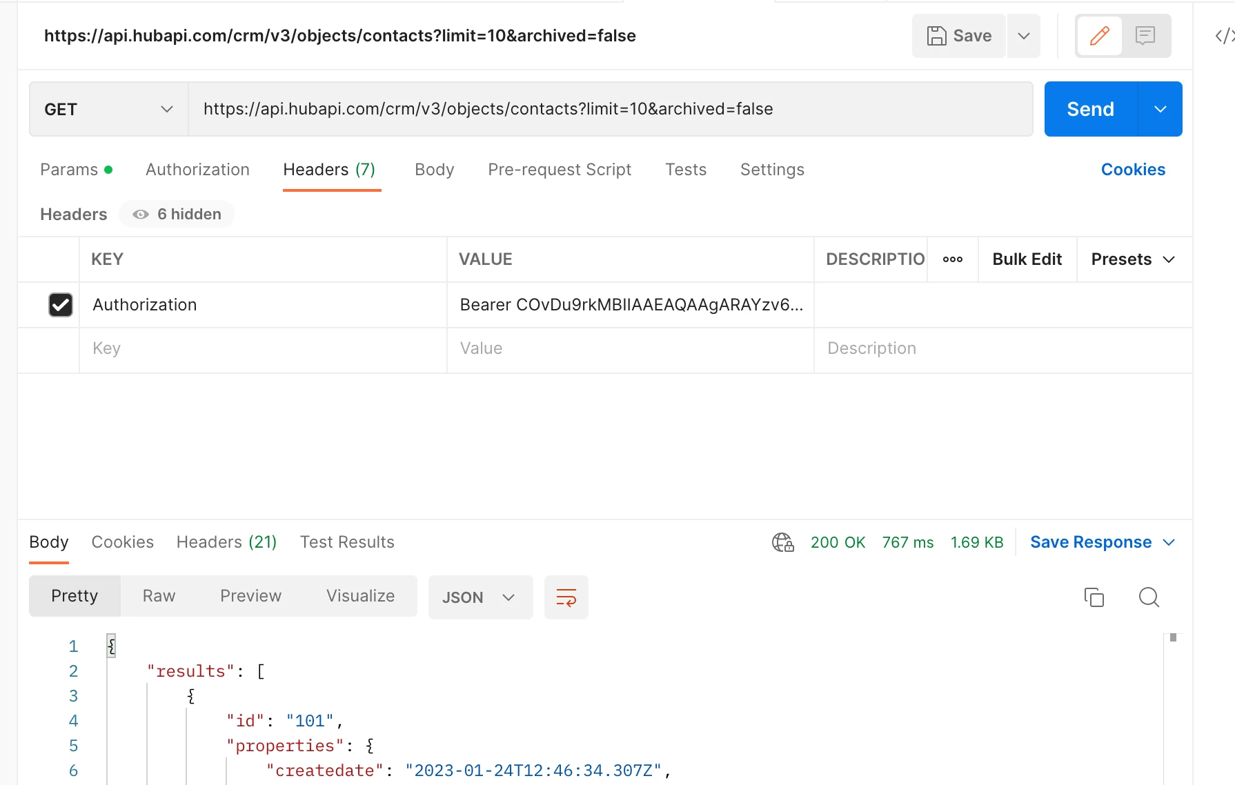

@anil_umachigi  I checked with API call. It is working, so tokens are correct. PFA reference image.

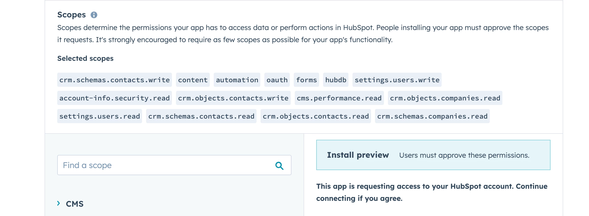

I have raised the support ticket. After the conversion with the team, they figured out the issues is because of the scope values which is getting added into the Hubspot app. Here, attaching the screenshot with list of scopes required for my successful integration.
