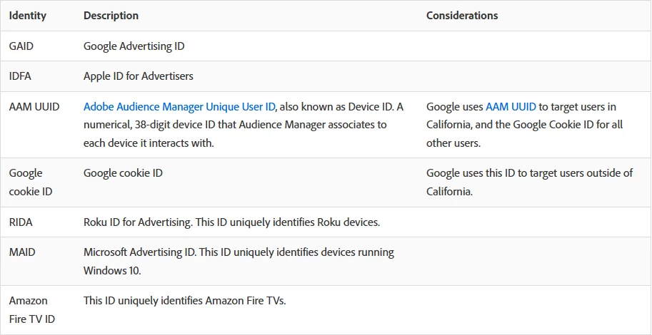

I would like to send some audiences to DV360 via HTTP API. I can´t do it using the native connection as I want to send hashed emails and this destination does not have it as an option:
Google Display & Video 360 connection | Adobe Experience Platform

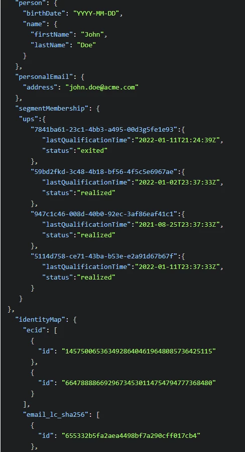

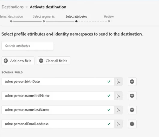

  2. I can see that tin the HTTP API I can only chose atributes for the export, but I can't map them, so, is there a way to change the structure of the export? I took this info from the HTTP API docu: HTTP API connection | Adobe Experience Platform
    The output will look like this:
    The question is if DV360 has a specific format for this type of export, would I be able to edit the format of the payload I am sending via this connection?

2. Data format:
The output format from AEP is a fixed JSON structure, as specified in the documentation. This format cannot be customized, so your endpoint must be able to handle and parse that exact structure.

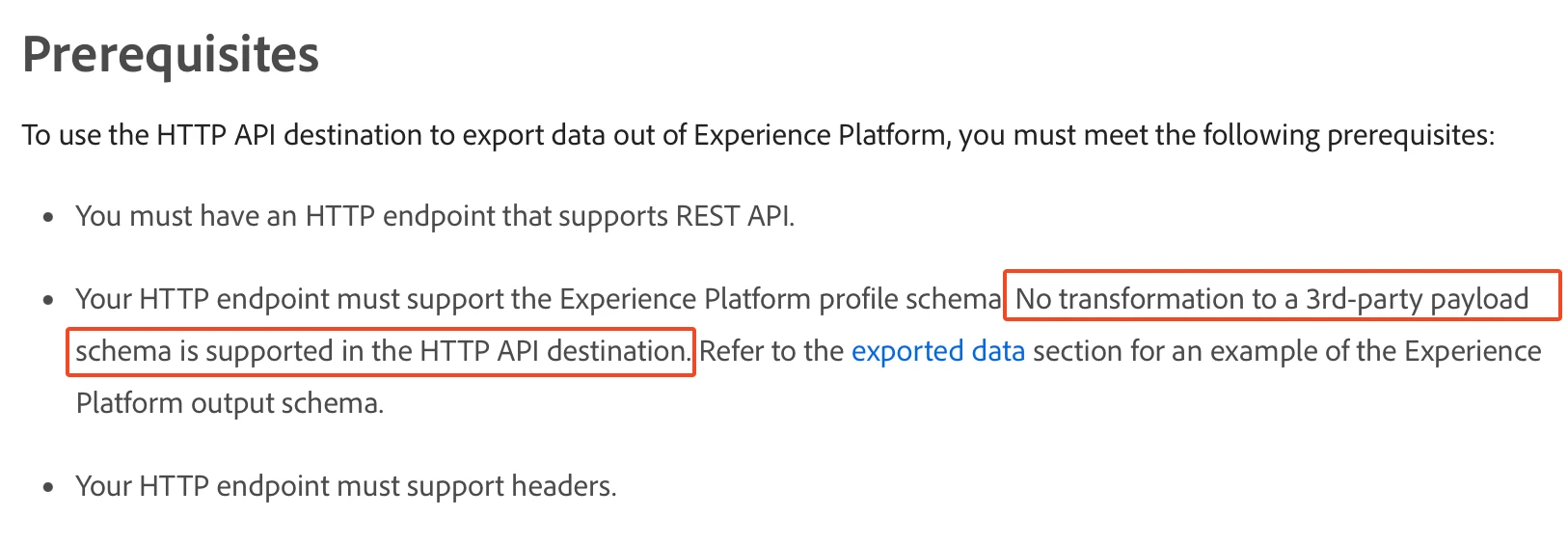

3. Using third-party APIs:
If you’re planning to send the data from AEP directly to a third-party API (like DV360), there’s a high chance the formats won’t align. Most third-party APIs expect their own specific structure, which AEP doesn’t natively support out of the box.
4. Recommended approach:
The best practice is to build your own intermediate HTTP endpoint (e.g., using Azure/GCP/AWS). AEP will push data to this endpoint in its native format. From there, your function can parse and transform the data as needed, and then forward it to the final destination (e.g., DV360) in the required format. This gives you full control over the integration and transformation logic.
