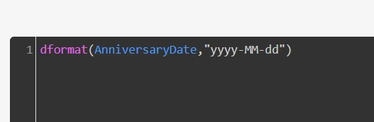

Hi All, I'm facing issue while converting unix timestamp to date field. here im using dformat for conversion and im getting only null values, but if i use specific timestamp like this -1652246442000 instead of "AnnivesaryDate" its showing me the correct result
the condition:
results
end result should be in this format 2022-02-10 so,can anyone help with these issue?

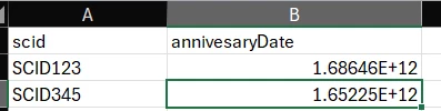

sample data which i used:

yeah correct while ingestion its taking the field(annivesaryDate) as string

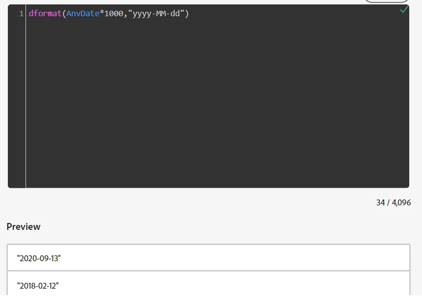

That’s the reason while performing dformat function in calculated field its showing null value and i have corrected the value(data in csv to 9digits(seconds) from 13digits(milliseconds) format) and while performing dformat function I have multiplied 1000 to field(annivesaryDate) so it will be in milliseconds format(dformat only accepts milliseconds) and now i can see the data in date format.
