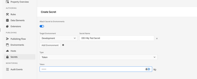

Well basically you create the secrets first and then create a data element that references the secrets.
The "Secret" data element type is able to handle different tokens to cater for the different environment stages.
Then, you can just use the regular functionality to retrieve data elements

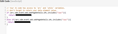

@bjoern__koth For token i am simply returning in this way, once this approach works then i was planning to add another token with condition.
For dynamic pixel ID following code i am using -
Ah, so you are hardcoding your tokens and don't use the Secrets approach Launch SSF brings?
Maybe try that approach and return the two data elements variations in your custom code instead.
Yes, I am passing it as hard coded value.
Could you please share any reference, how to fetch Secret in data element.
getDataElementValue('myToken')
