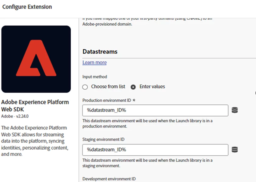

Using dynamic Datastream ID value in WebSDK extension.
We are using Web SDK and working on a scenario where the data has to be sent to a different report suite and also event forwarding destinations depending if the web page is accessed in mobile web view or normal browser.
We thought of using Datastream report suite override but it seems it cannot take care of the event forwarding destinations.
So we created 2 differnet data streams, and tried to use the "Enter Values" in the Web SDK extension Data Stream config., like below,
But it is not working as expected, as the data stream ID always follows the default value of the data element, and it won't use the other data stream ID value popluated.
Anyone have experience on this?

Hi @anil_umachigi
The data element value for the data stream ID is populated in a button click event, so there should be no race condition. And we still see the event call sent to the default data stream ID.
John
Just found that it's possible to override the whole Data Stream ID in the rule/sendEvent level.
Not sure why the same setting in the extension level does not work, but we tested the one in the rule/sendEvent level and it works.

Since we also need to send to different server side forwarding destinations, datastream override seems cannot help.
Apart from the other methods you mentioned. Would also like to understand more on why it's allowed to enter data element as values for the Data Stream ID in the Web SDK extension config?
Just received an update from Adobe that this issue is fixed, i.e. we can use a data element variable as the data stream ID in the Web SDK extension level, and when you send event, the data stream ID will be based on the run-time value of the data element.
