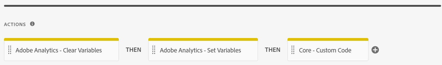

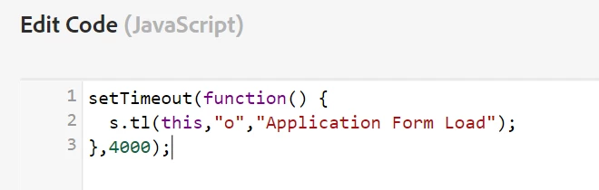

Both direct calls rules Action sequence
Added delay for both direct call rules so that these both do not fire prior to the Page view call.

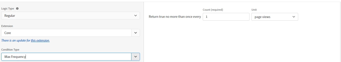

Best answer by Gokul_Agiwal
Hi @sek_23
I hope you have setup 2 separate rules. rule ordering allows you to control the order of execution for rules that share an event of same type.
So you can try like below
1) create a rule (which you already created) with direct call events.
2) Add condition and action with your direct call rule
3) Add Max Frequency condition like below
Please chose the Unit based on your scenario.
So here in this case,
When direct call triggered the rule fired, it check max frequency condition, if this is the first time then rule will run and frequency will be 0, rule continue running and update to frequency 1.
if direct call triggered again then rule will run however this time max frequency condition will fail so the rule stops there and action won't execute this time.
Hope this helps.

Gokul_Agiwal
Gokul_AgiwalCommunity AdvisorAccepted solution
February 17, 2022
Hi @sek_23
Hope this helps.
