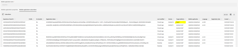

I'm working with multiple app dev teams and some of them are reporting that some Android devices being registered target platform Apple.
I believe this is something code related because my application registers fine on the same Launch property, but I wondered if anyone with technical knowledge of this process might be able to explain what might be the issue here.
See top line below...

Hi @jaelliott ,
The target platform that a device has on ACS is determined by the ACP SDK which is running on the device (Android or iOS). I remember in a previous post you had mentioned that collectPii had been used to register devices on ACS. Has the Launch rule using collectPii to register devices been disabled? One possible cause for this issue is that you may have some Android devices which are incorrectly triggering the collectPii rule setup for registering iOS devices.
Additionally, it would be very helpful if you could provide some debug logs from devices that are showing the issue.
Ryan
