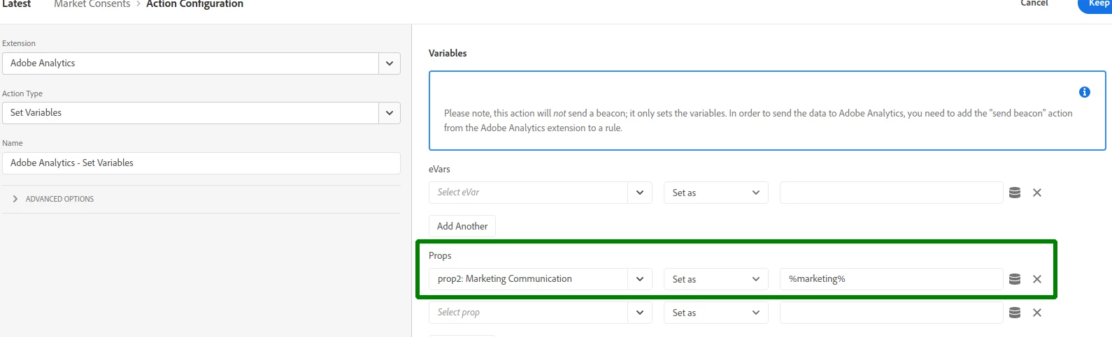

In the data collection I created a rule with "Core - Direct Call" event and in the actions I pointed to my prop2, I also created a "Data Elements" called "marketing":

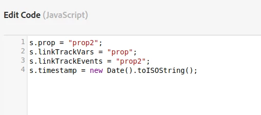

And in that same rule I put the following custom code:

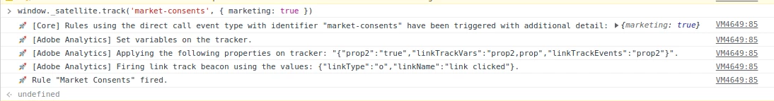

When firing from the browser console I see that it sends the information:
But unfortunately this information does not arrive on the adobe dashboard.

You're doing it wrongly.
If you're able to set the prop/eVar/event/etc using the form in the "Set Variables" action, like what you've done in the first screenshot, then that's all you need. You don't need to set any custom code at all.
If you want to set it with custom code, though, then well, your code is wrong. It should be like this:
s.prop2 = _satellite.getVar('marketing');  // this sets your prop2 variable with the value returned by the "marketing" data element
s.linkTrackVars = 'prop2';
// ideally, you shouldn't set linkTrackVars like this, just in case linkTrackVars had already been set with some other value in another rule or action
// so the below is actually better:
s.linkTrackVars = s.apl(s.linkTrackVars, 'prop2');
// now, you'll also need to add the "apl" plugin, available from the Common Analytics Plugins extension
// if you don't want to use that extension, then the following works too:
if (s.linkTrackVars) {
s.linkTrackVars = [s.linkTrackVars, 'prop2'].join(',');
} else {
} // finally, you don't need to set linkTrackEvents since you're not setting any success events
} else {
